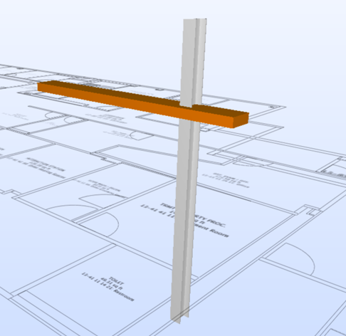

Typically, the automatic visualization setting will show the components related to an issue and hide other components in the model. For a coordination check, where the goal is to find intersecting components, that would mean the result would look like the image below.

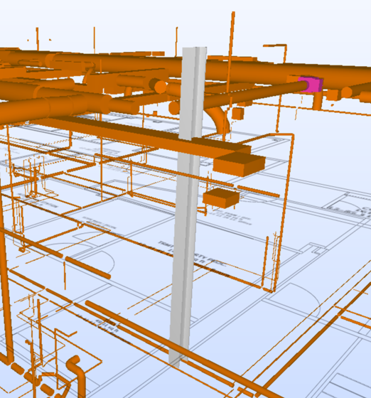

Automatic visualization can be supplemented with other components, as well. If, for example you would like to add all the 1st Floor ductwork to the above image, you can use the Model Tree to choose the components you would like to add, then select the (+) icon in the Model Tree to add them to the view. The results in this example will look like the image below.

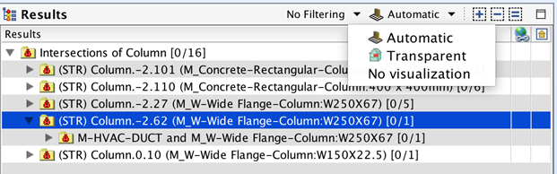

In rare cases, the automatic visualization setting can also be changed to either ‘no visualization’ or ‘transparent.’ The transparent setting will turn everything transparent except the components related to the issue, providing you with a perspective that includes all the surrounding elements and systems, while the ‘no visualization’ option will turn off all visualization of results; nothing in the 3D window will change to reflect the results.
