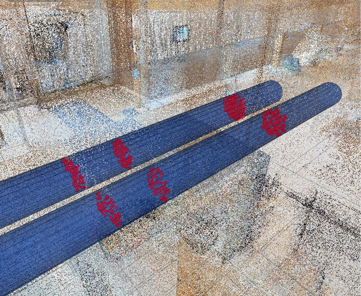

The Point Cloud Clash Check reports model components where scan points fall inside or near the component, within a configurable clash tolerance. When laser scan data penetrates the boundary of a modeled element, or comes within the defined tolerance of it, the rule flags the component as a clash result.
This check identifies cases where a built element occupies space that the model assigns to a different component: pipes running through structural members, ductwork encroaching on reserved zones, or partitions built in positions that differ from the design. Each result links to the affected model component and the scan data that triggered it, surfacing the exact location in the 3D view for review and coordination.

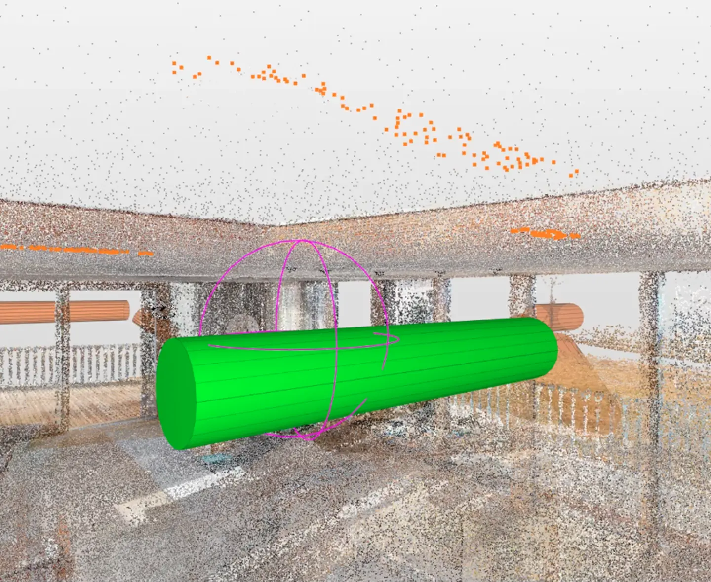

The Point Cloud Clearance Check reports model components where scan points fall inside a configured clearance range around the component. Where the Clash Check identifies penetrations, the Clearance Check identifies insufficient separation: the space around a component is specified in the model, but the scan shows that built elements encroach on it.
This check is relevant wherever minimum clearance is a design or regulatory requirement: maintenance access routes, emergency egress corridors, equipment service zones, and fire safety compartments. The clearance range is configurable, giving teams the ability to enforce different clearance standards for different component types or conditions within a single checking pass.

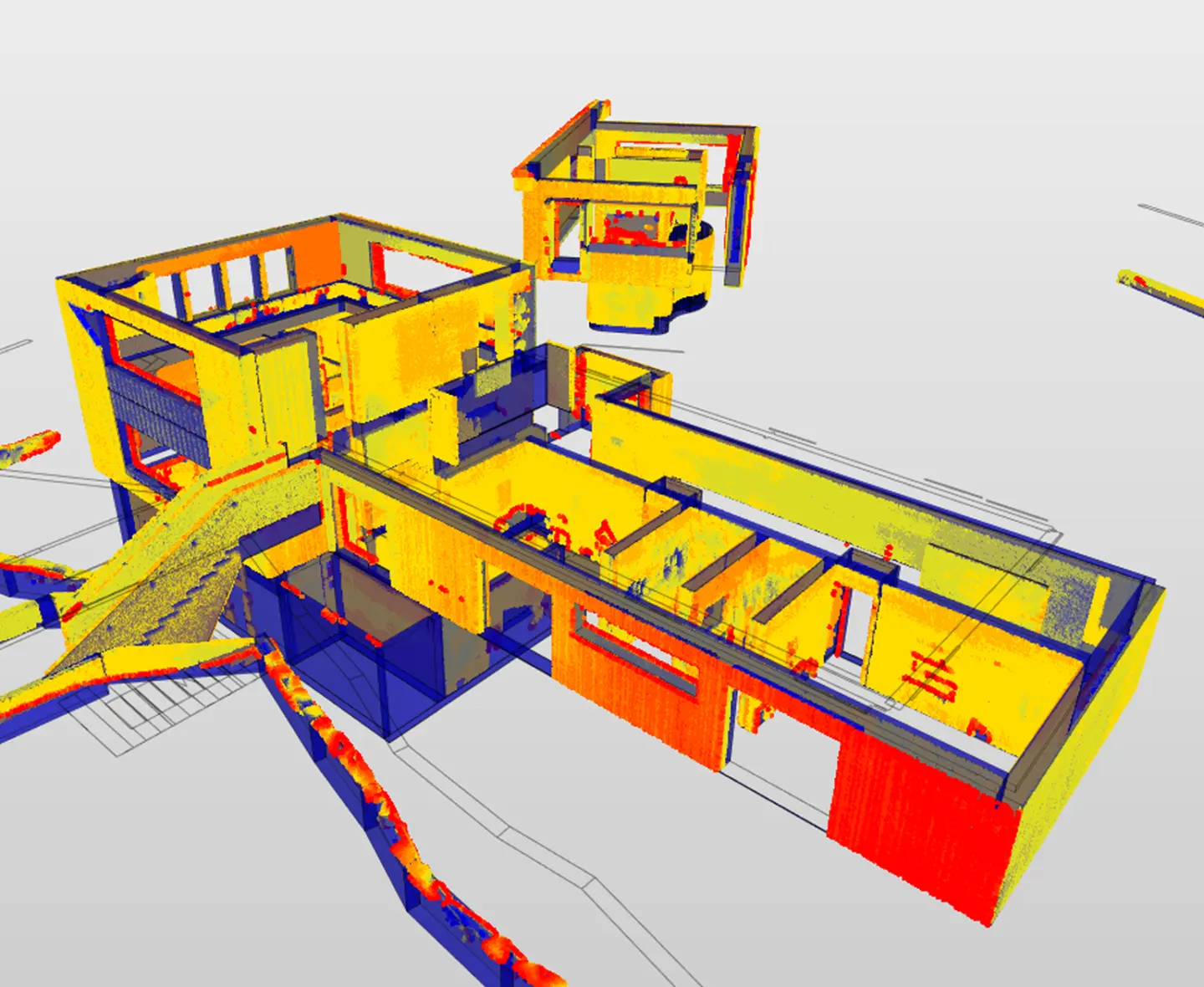

The Point Cloud Matching Check detects deviations between point cloud data and model components, including unmatched point data. Where the Clash and Clearance checks identify spatial conflicts, the Matching Check identifies positional and geometric divergence: components that exist in the model but are not reflected in the scan, scan data that has no corresponding model component, and components whose modeled position or geometry does not match what was built.
This check is the core as-built verification tool for comparing design intent against constructed reality. It reports both model-side discrepancies and scan-side discrepancies, providing a complete picture of where the as-designed and as-built states diverge.
