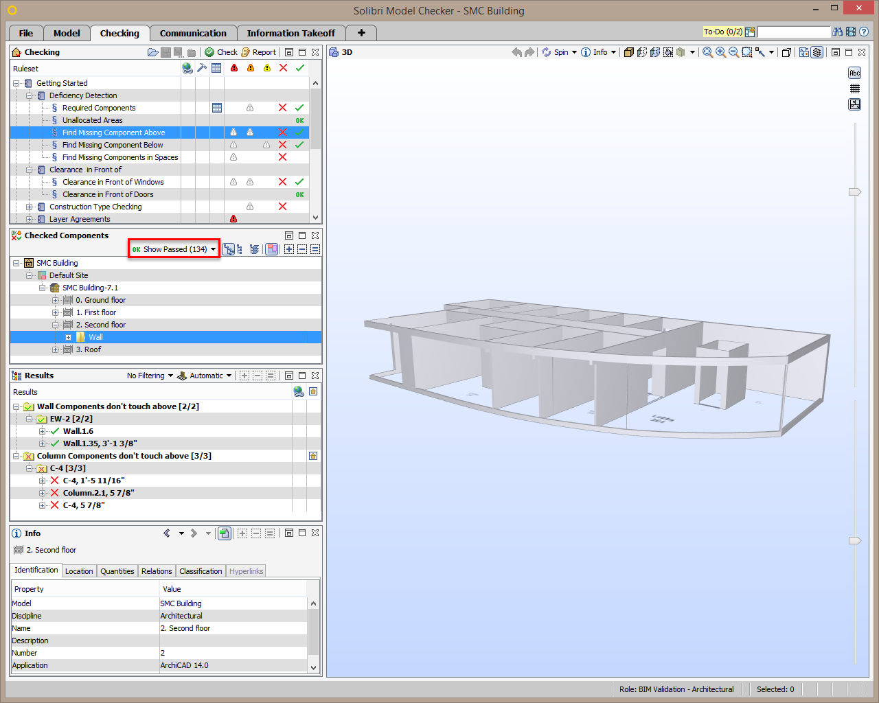

By selecting Show Passed, the tree lists all components that passed the check, as these components have a component touching them from above that was defined in the Touching Components Filter Parameters Table.  By switching to the Containment Hierarchy, you are able to select components from specific stories in the building, thereby isolating those components in the 3D View.  Below we see the walls on the second floor that pass this check:
Show Passed

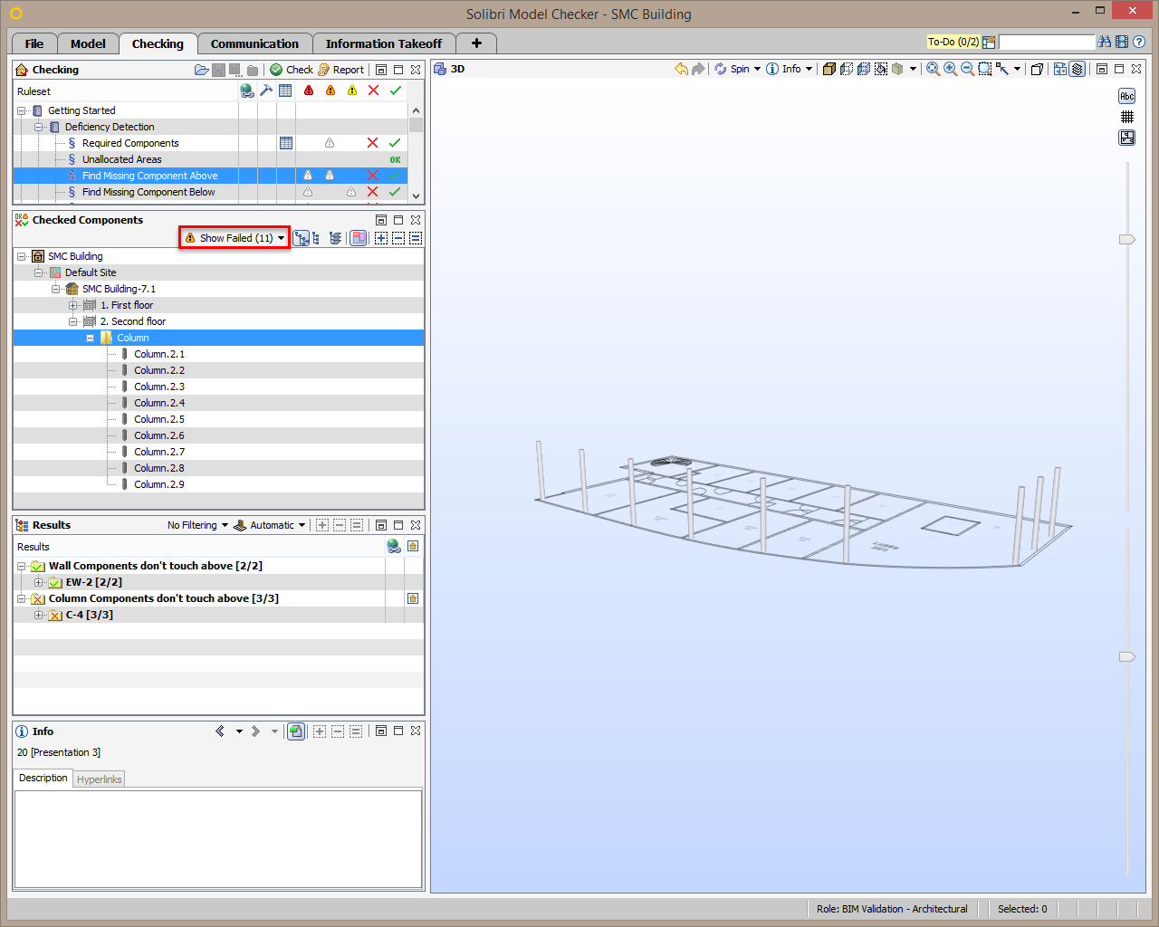

By setting the dropdown to Show Failed, we can view the 9 columns on the Second floor level that fail this check, as they have no components above.
Show Failed

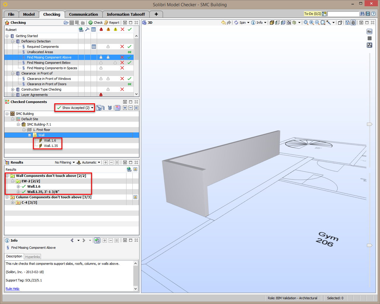

By setting the drop down to Show Accepted, we see 2 balcony walls on the First floor level that failed the check but were considered non-issues when reviewed.
Show Accepted

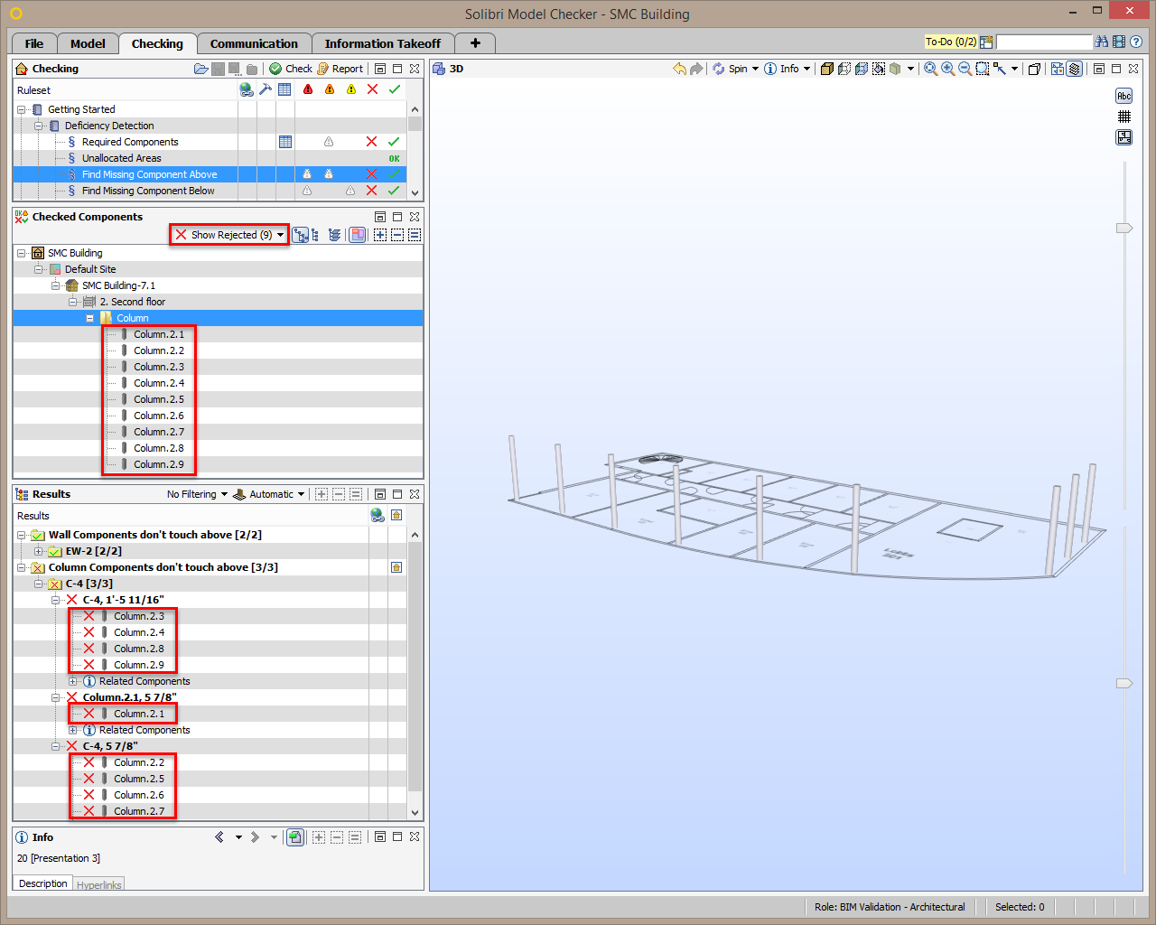

By setting the drop down to Show Rejected, we see the 9 columns again on the Second floor that failed and were rejected as actual issues since they should be supporting a roof that touches them from above.
Show Rejected

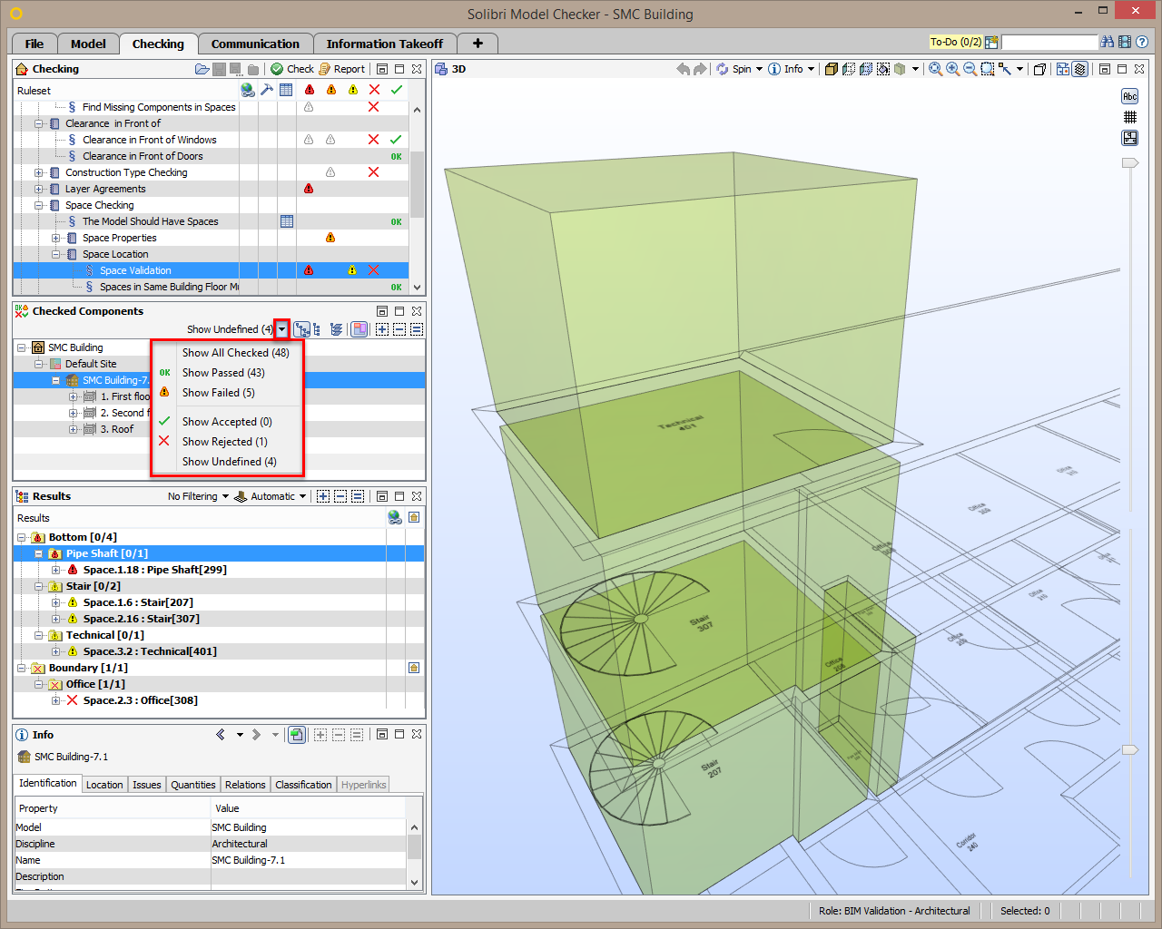

Selecting the Space Validation rule in the Checking View and selecting Undefined in the drop-down box of the Check Components View, you’ll see that there are four spaces listed as Undefined near the stairwell.  Also notice, the drop-down box itself lists the counts of components of each category.  To summarize the listings of the Checked Components View for this rule, of the 48 spaces that were checked, 43 passed, while 5 failed with issues.  Of the 5 spaces that have issues, only one space was reviewed and rejected as an actual issue, while the remaining 4 spaces have yet to be accepted or rejected and are listed as undefined:
Show Undefined
