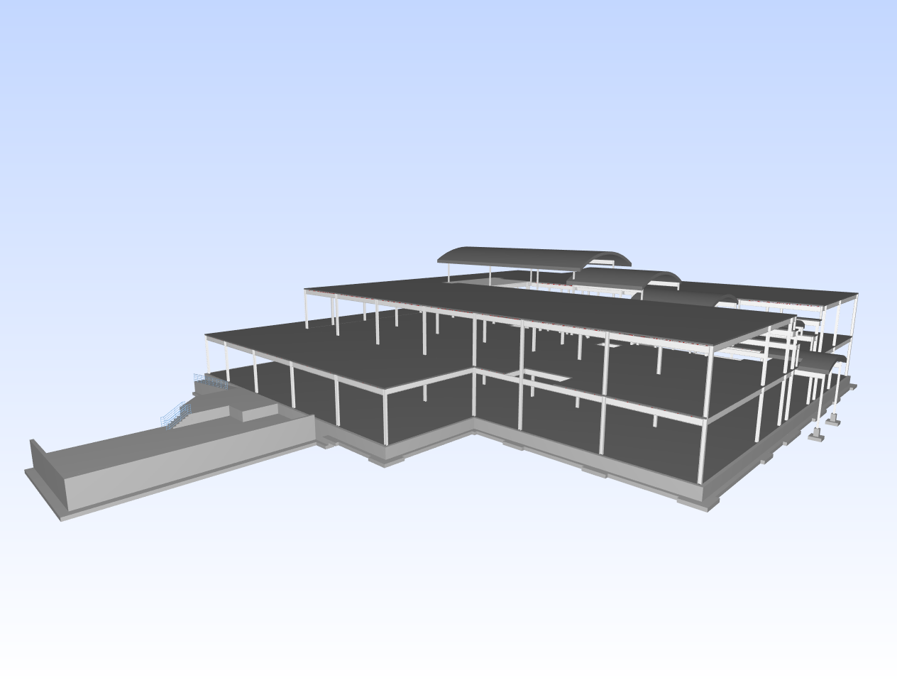

However, it may be useful to differentiate components visually by color, based on their discipline, the type of component, or what system they belong to. For example, the structural model below looks realistic, but it isn’t very easy to discern the different components:
Model Colors of a Structural Model

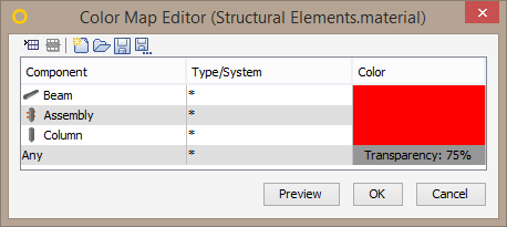

Using the Add New Row and Remove Selected Row buttons, you can add and remove rows for components and set their colors by double clicking in the color cell. For example, we can remove all rows except Beams and Columns, add an additional row for Assembly components, and set all three components to display red.  We then add a last row for ‘Any’ other component that has a grey 75% transparent color as shown below:
Color Map > Structural Elements Edited

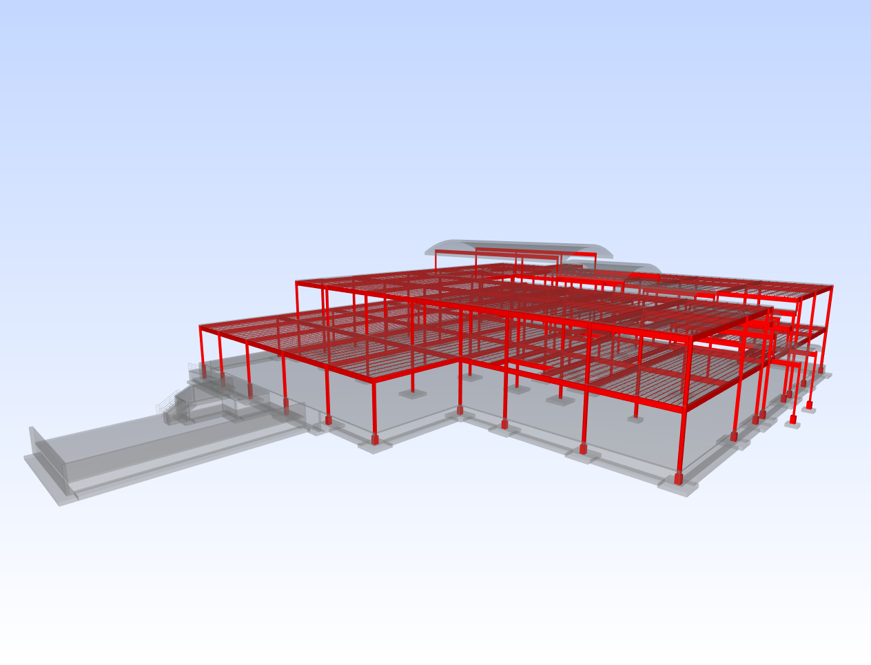

Upon clicking OK, you’ll now see the beams, columns, and assemblies highlighted in red as specified in the Color Map Editor:
Edited Structural Elements Color Map

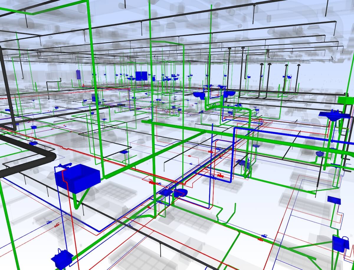

With the color map applied, the plumbing stands out in the 3D View differentiated by system:
Revit Plumbing Color Map Applied

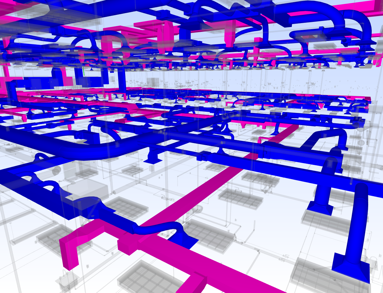

With the color map applied the HVAC stands out in the 3D View differentiated by system:
Revit HVAC Color Map Applied

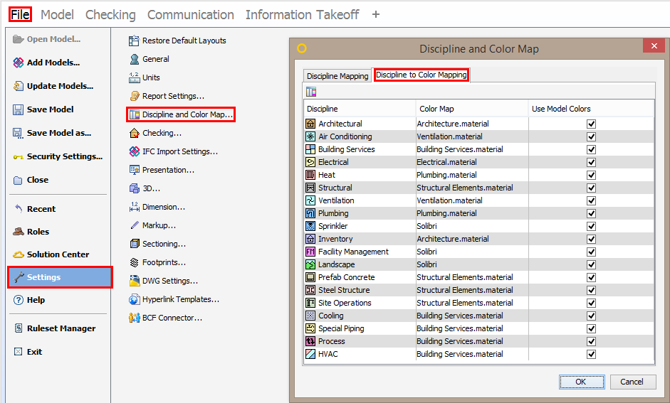

Color Maps can be applied to models based on their discipline at the time they are opened, through the settings option in SMC.
Click File > Settings > Discipline and Color Map… > Discipline to Color Mapping.
A dialog will open that maps disciplines of files to different color maps.  By default, the disciplines are set to various color maps; however, the Use Model Colors checkbox is marked, which is why model colors are used:
