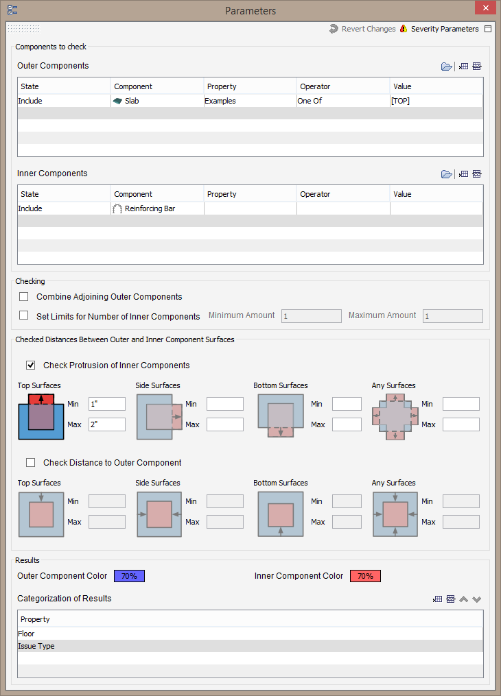

In the rule parameters of the Slabs checked by Top Surface Protrusions 1″-2″ rule, slabs classified as examples for checking top surfaces are listed in the Outer Components filter parameter table.  Reinforcing Bar is listed in the Inner Components filter parameter table.  There is a checkbox marked for the Check Protrusion of Inner Components, option.  A minimum value of 1” and maximum value of 2” is specified for Top Surface protrusions.
Rule Parameters for Slabs checked by Top Surface Protrusions 1”-2”

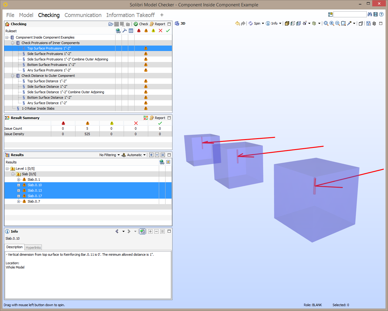

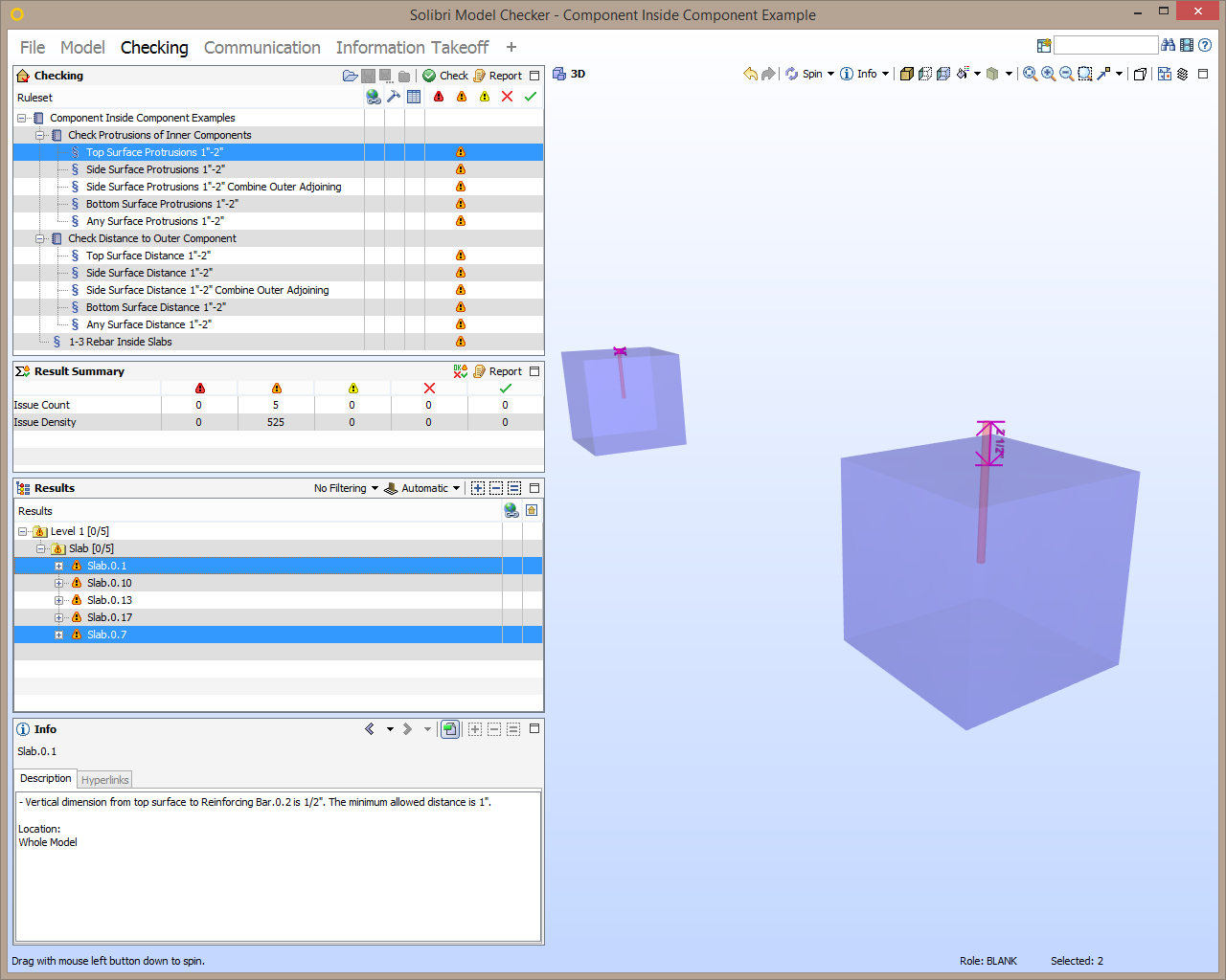

In the results, the two slabs that have a .5” and 2.5” protrusion are listed as results, and dimension lines visualize the incorrect protrusion distances.
Results of protrusions greater than and less than the minimum and maximum allowed.
Likewise, the 3 slabs that have rebar running vertically toward the top surface but do not penetrate are returned as results, as those rebar have a 0 value of protrusion, where the minimum is 1″.  Red arrows point to the rebar that don’t protrude through the slabs.

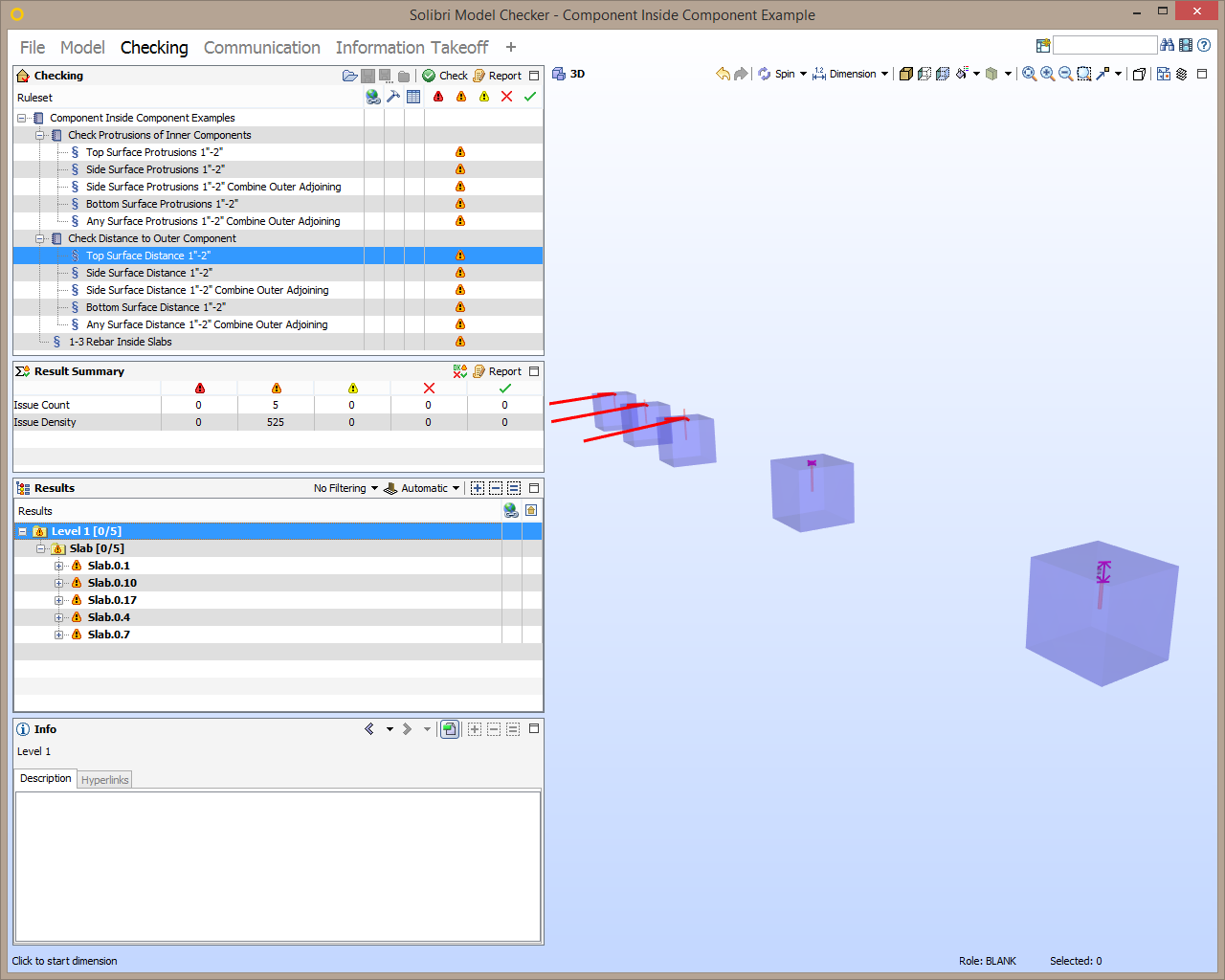

Checking Distances of Inner Components
The Check Distance to Outer Component ruleset provides examples of checking the distance of inner components to the surfaces of outer components.  Again, the first rule, Top Surface Distance 1″-2″, checks the west-most column of rebar that runs vertically through or close to the top surface of the slabs.

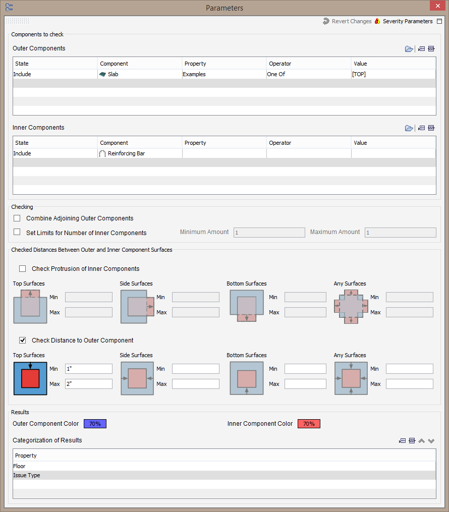

n the rule parameters of the Top Surface Distance 1″-2″ rule, slabs classified as examples for checking top surfaces are listed in the Outer Components filter parameter table.  Reinforcing Bar is listed in the Inner Components filter parameter table.  There is a checkbox marked for the Check Distance of Inner Components, option.  A minimum value of 1″ and maximum value of 2″ is specified for Top Surface distances.
Rule Parameters for Top Surface Distance 1”-2”
In the results, the visualization of the issues is now the opposite, where rebar that protrudes from the top surface and has a 0 distance is displayed with a red arrow pointing to the rebar.  The two slabs that have rebar at distances of .5″ and 2.5″ to the top surface of the slab are listed as results, and dimension lines visualize the incorrect distance amounts.
Results of Top Surface Distance 1”-2”

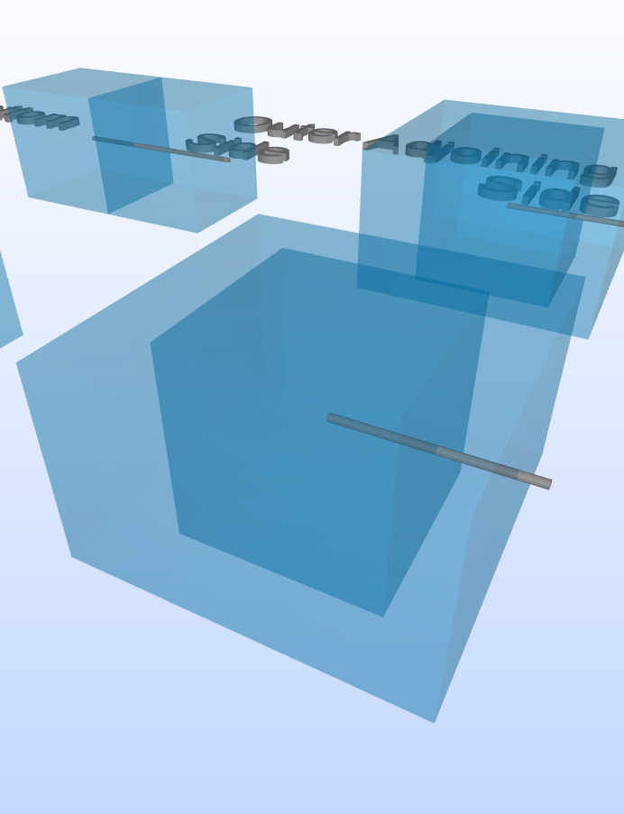

Upon closer inspection, one column contains slabs that are side-by-side:
https://solibri-assets.s3.amazonaws.com/components-inside-components-sol-234_01.png
While the other column contains slabs that are inside one another:
Outer Adjoining Components Inside

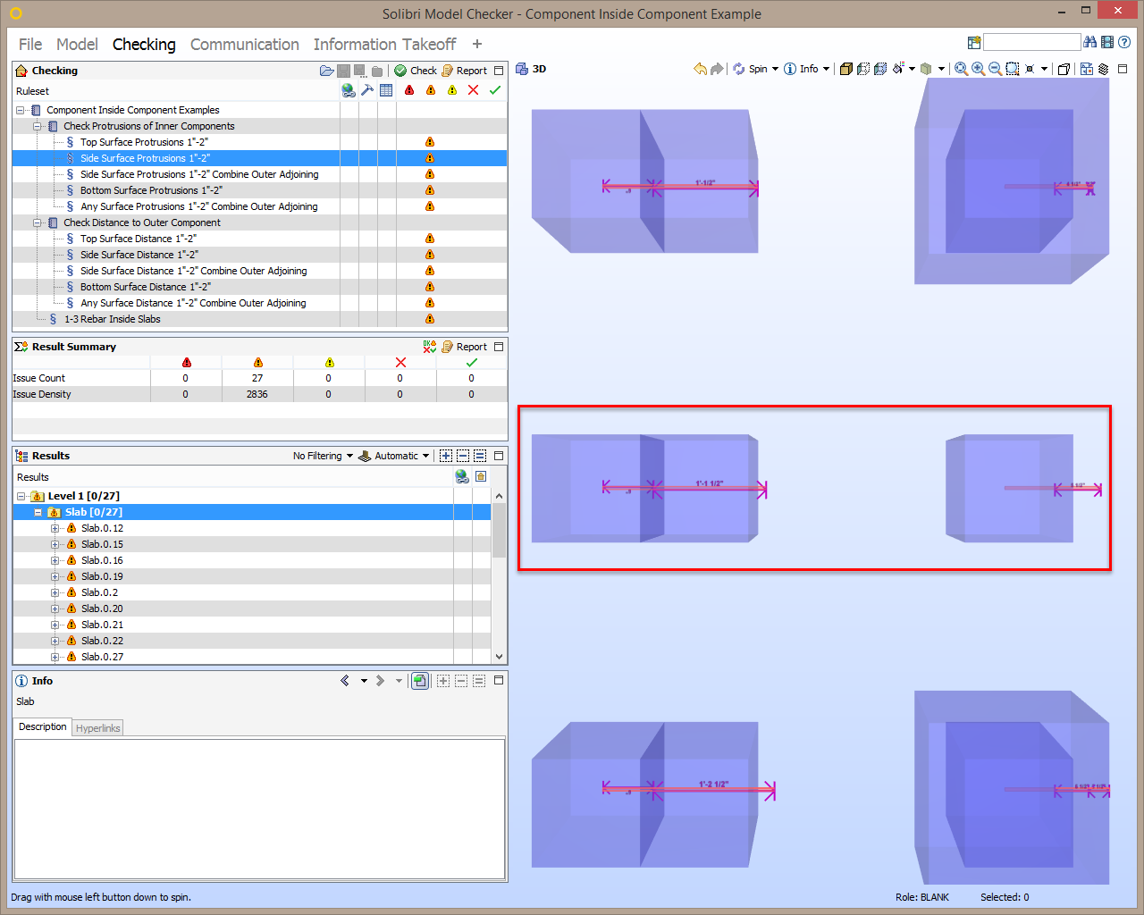

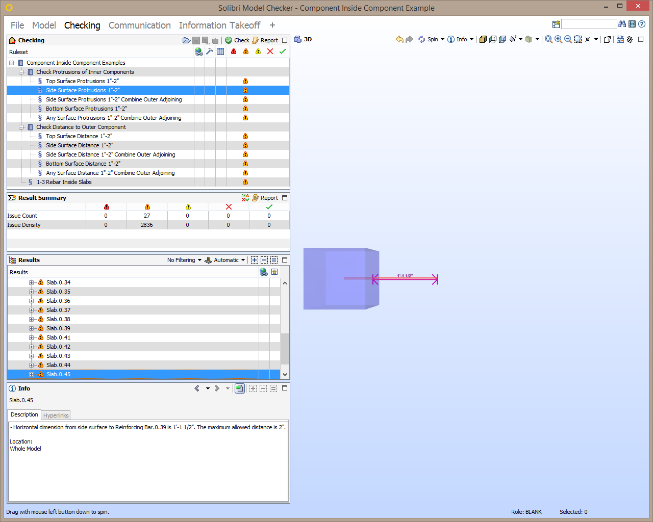

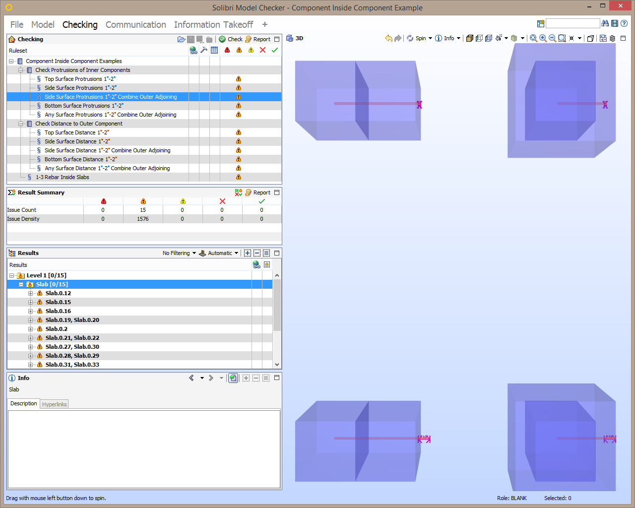

In the results of Side Surface Protrusions 1″-2″, the middle examples are returned as results even though the rebar is protruding 1.5″ inches from the slab:
Results of Side Surface Protrusions 1”-2”
The results provide information as to the issue, as the rebar is protruding a distance of 1′-1.5″ from the slab on the left:
Protrusion of 1’-1.5”
Marking the Combine Outer Adjoining Components option in the rule parameters allows adjoining outer components to be treated as a single outer component.  By marking this option in the Side Surface Protrusion 1″-2″ Combine Outer Adjoining rule, the slabs are treated as a single outer component. In the results of the rule, only the rebar that is penetrating .5″ and 2.5″ from the right slab and outer slab are returned as results, and the rebar that protrudes 1.5″ passes, since it is within the 1″ min / 2″ max requirement:
Results of Side Surface Protrusions 1”-2” Combine Outer Adjoining

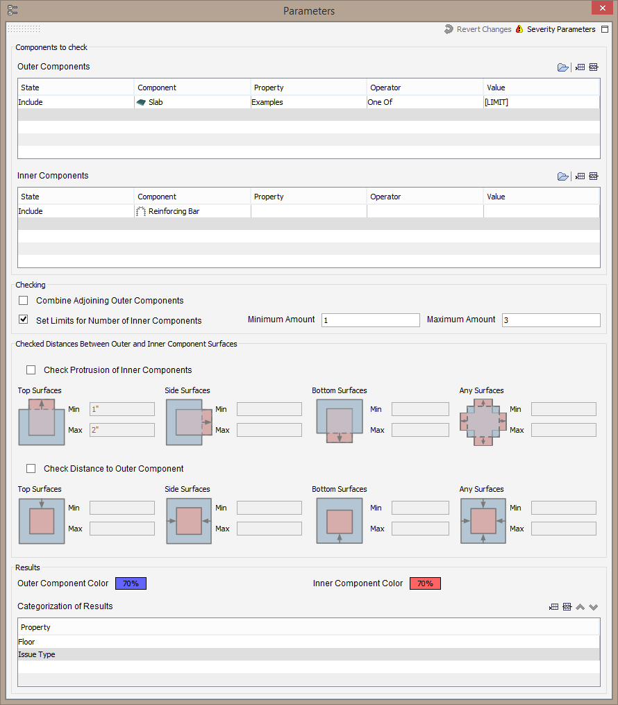

The Component Inside Component rule template allows for a check for a minimum and maximum number of inner components.
In the rule parameters of the 1-3 Rebar Inside Slabs rule, the Set Limits for Number of Inner Components checkbox is marked, the Minimum Amount is set to 1, and the Maximum Amount is set to 3:
Rule Parameters of 1-3 Rebar Inside Slab

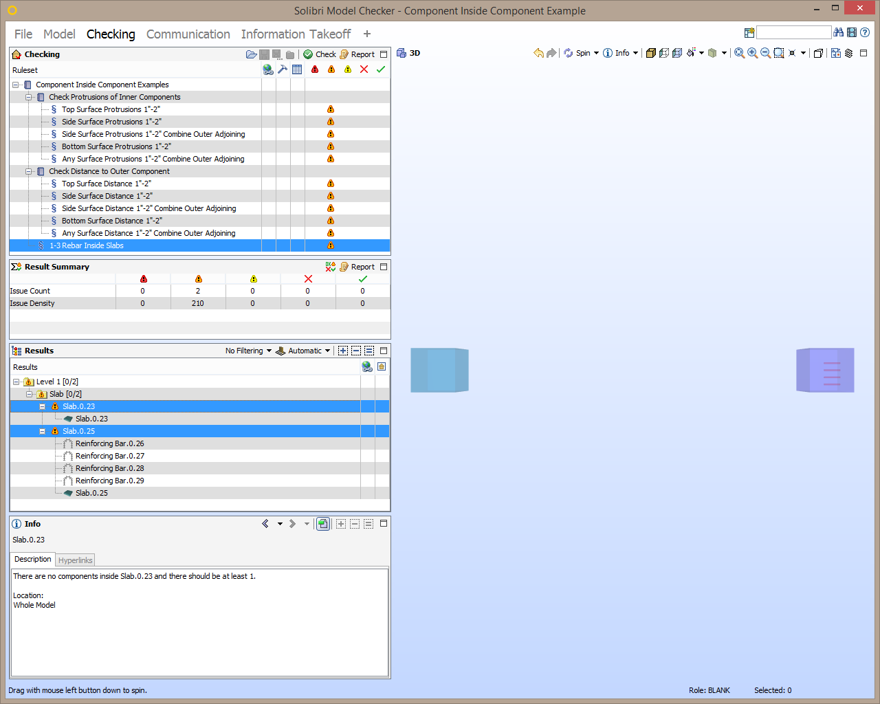

In the results of the check, the slab that doesn’t contain any rebar is returned as an issue, since there is a minimum of 1 required.  Likewise, the slab that contains 4 pieces of rebar is returned as an issue, since there is a maximum of 3 required.  The slabs that contain 1, 2, and 3 pieces of rebar pass the check:
