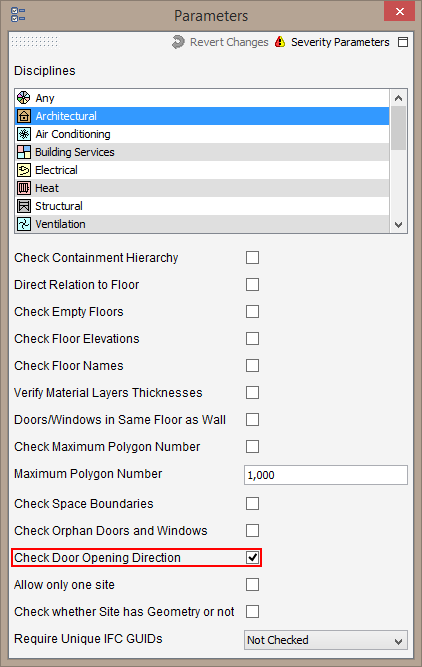

Within SMC, you can check your model to ensure that door operations are defined by marking the Check Door Opening Direction checkbox in the Model Structure (SOL/176) rule template.
"Check Door Opening Direction" parameter of Model Structure (SOL/176) rule template

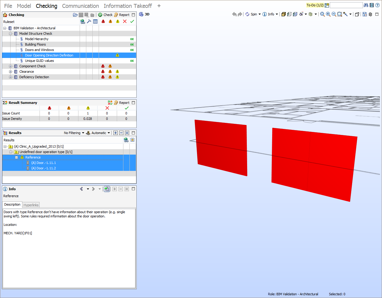

The BIM Validation – Architectural ruleset that is included in the Rulesets folders of Solibri Model Checker (SMC) contains a rule that ensures door operations are defined.
Results from Door Opening Direction Definition check

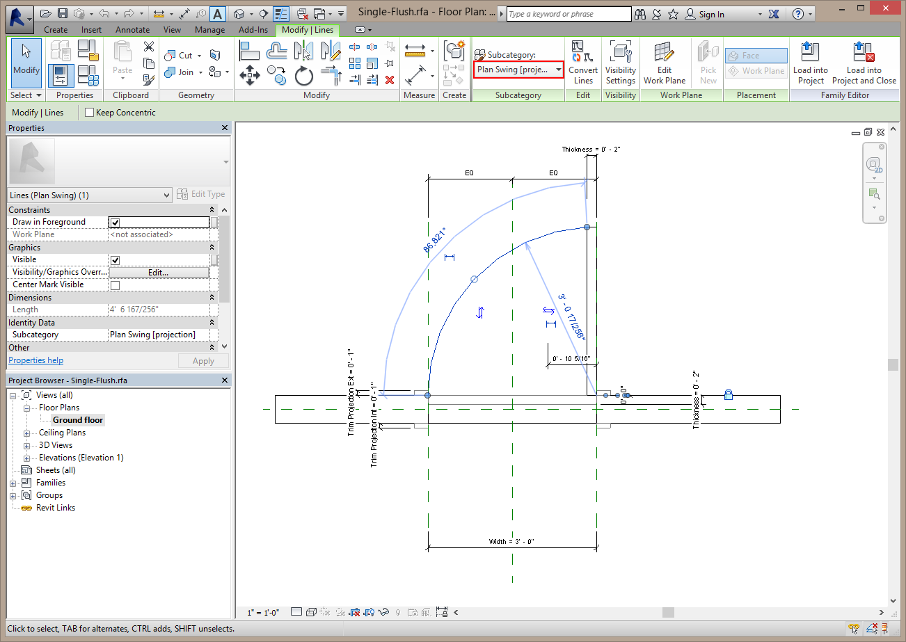

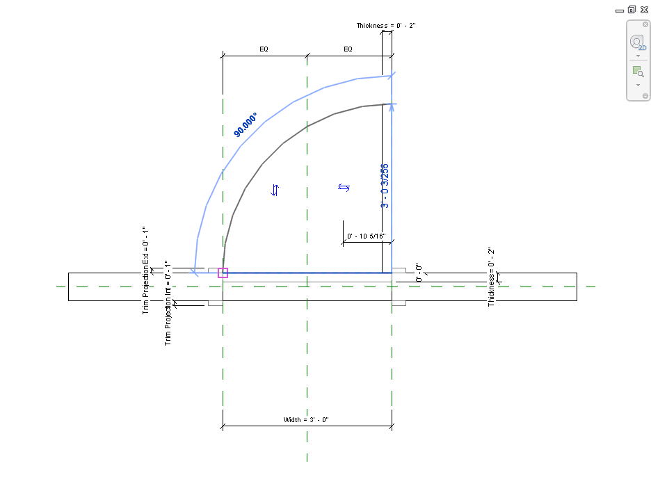

When creating single swing doors in Revit, the operation can automatically be set by modeling the Plan Swing subcategories of the doors using the symbolic lines tool.
Below, this Symbolic Line annotation is selected in the Ground Floor view of the Door Family in the Family Editor within Revit.
Plan Swing [projected] Symbolic Line of a door
Notice the subcategory of this symbolic line is set to Plan Swing [projection].  The subcategory can be set to either Plan Swing [projection] or Plan Swing [cut] to designate the swing and thereby populate the operation of the door.

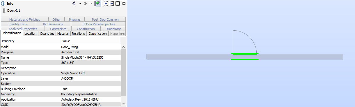

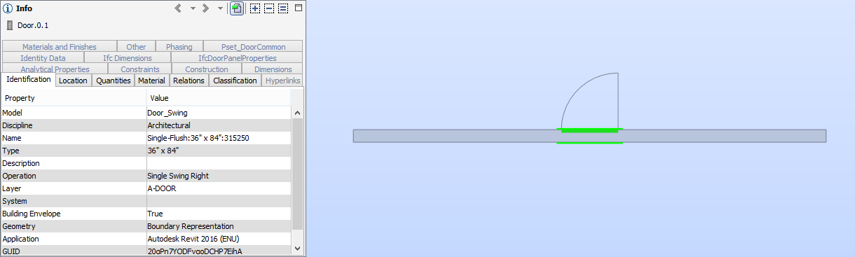

When the exported IFC is opened in SMC, you can see the swing in the footprint as well as the Operation property has the value Single Swing Right.
Door with Single Swing Right operation in SMC

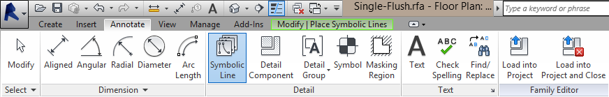

To add the Symbolic Line for the Plan Swing in Revit, click Annotate > Symbolic Line.
Annotate > Symbolic line in Revit

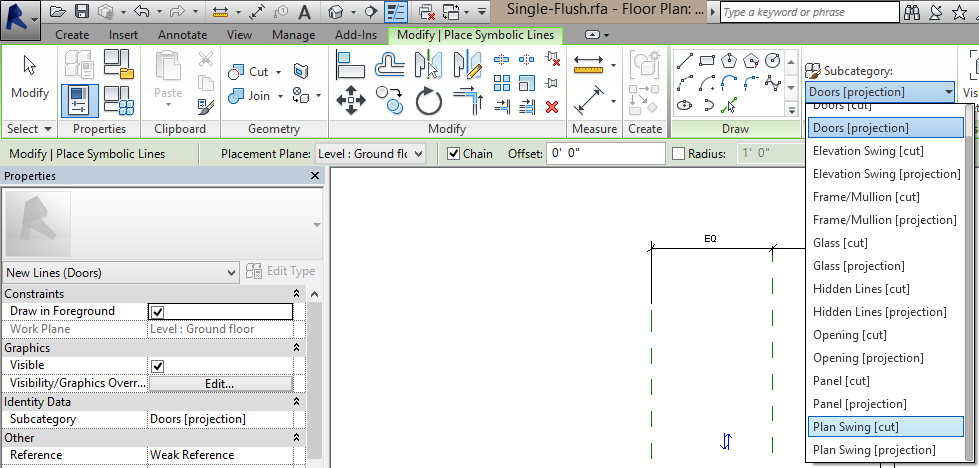

In the Subcategory dropdown list, select either Plan Swing [projection] or Plan Swing [cut].
Setting the Subcategory of the Symbolic Line to Plan Swing [cut]

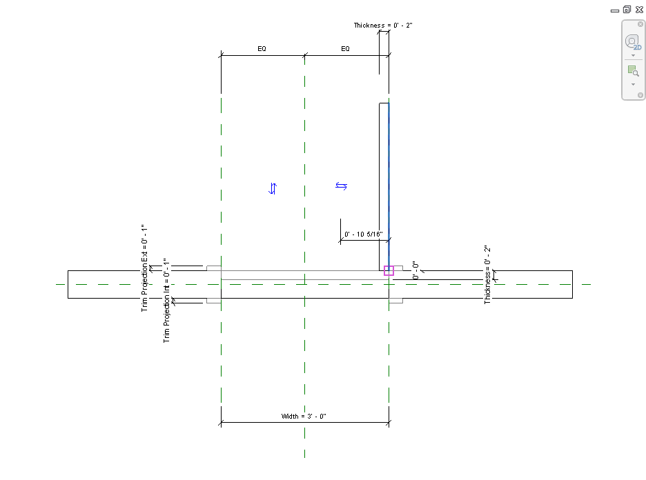

For the center of the arc, click the point where the panel meets the hinge of the doorway.
Selecting the center of the arc

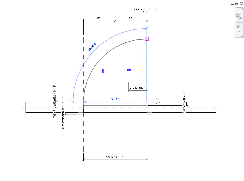

For the start-point, click the point where the panel is swung open 90 degrees.
Selecting the start point of the arc

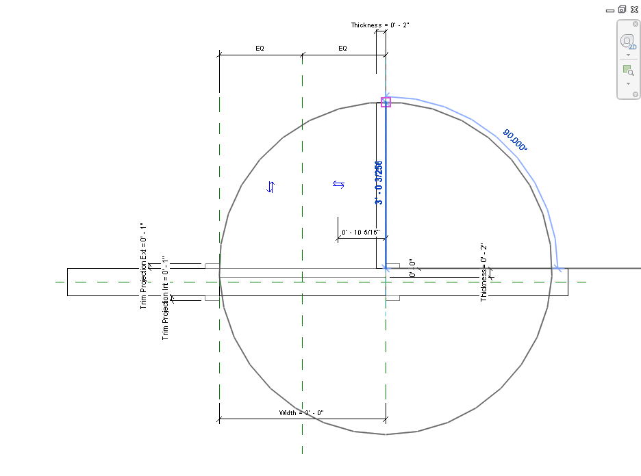

The order by which you select the start and end points is very important. If after selecting the center of the arc, you were to swap the start and end points as seen in the two screenshots below, the operation will be reversed in the exported IFC, even though it still appears correct in Revit.
Incorrect start point selected; this should be the end point of the arc
Incorrect end point selected; this should be the start point of the arc

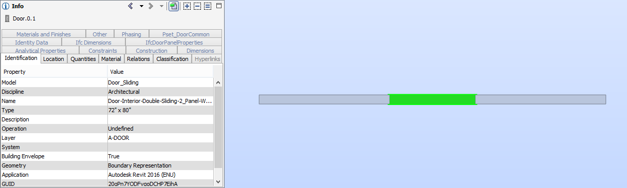

There are many different door operations, such as sliding, folding, etc., that don’t have a swing to model.  In these cases, you can specify the operation in the Operation parameter of the IFC Parameters group within the family in Revit.
For example, below is an out-of-the-box door from Revit with a Double Door Sliding operation loaded in SMC.  The operation is Undefined.
"Undefined" Operation for Sliding Double Doors

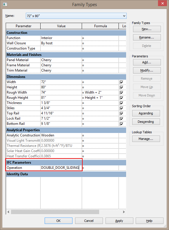

To set the operation, open the door in Revit and click the Family Types button in the Properties panel of the Create ribbon.
Create > Properties > Family Types button in Revit
Below, we specified the IFC Parameters > Operation property as DOUBLE_DOOR_SLIDING. Notice we used underscores rather than spaces.  This is important, as the value has to come directly from the enumeration IfcDoorStyleOperationEnum from IFC.
Setting the Operation property in the Family Types window
You can find the listing of valid operation values through this link: IfcDoorStyleOperationEnum

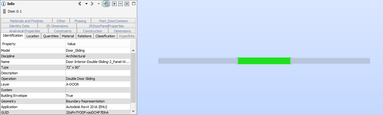

When loaded in SMC, the operation is defined. Note door swings only show up in the footprint of SMC for Single Swing and Double Door Single Swing doors.
Door with "Double Door Sliding" Operation correctly set in the IFC
