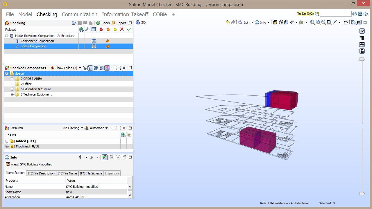

In the Checked Components window, the ‘Failed’ items from each model are listed by default.

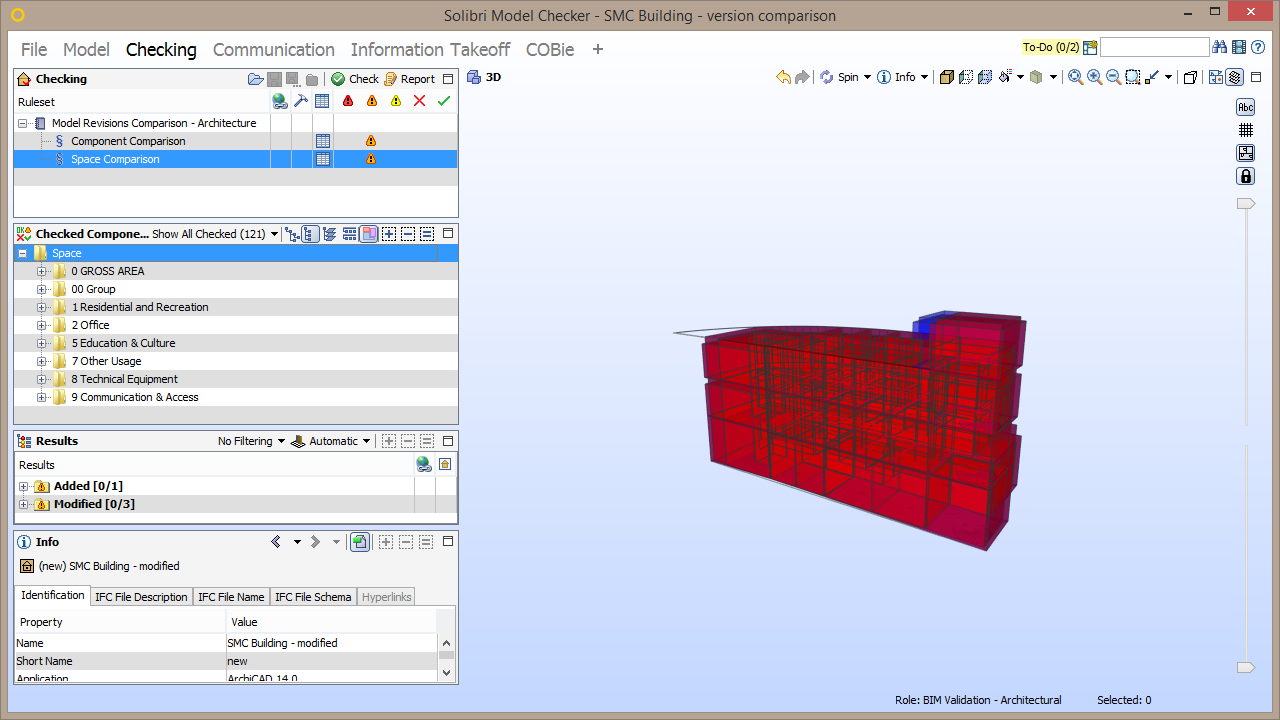

By selecting the dropdown next to ‘Show Failed’ other visualization options appear.  ‘Show All Checked’ lists the components that have been checked using the rule.  If all components in the model are listed, that means all components will have been run through the model comparison.  By selecting ‘Show All Checked,’ the 3D window will display the checked components.
You can then navigate through the model to verify that the space or component in question is displayed.  If it is not, then it is not one of the components that were checked.  As mentioned before, this could be due to an exemption of this space in the rule parameters, and can be addressed by correcting the rule parameters to include such space changes.

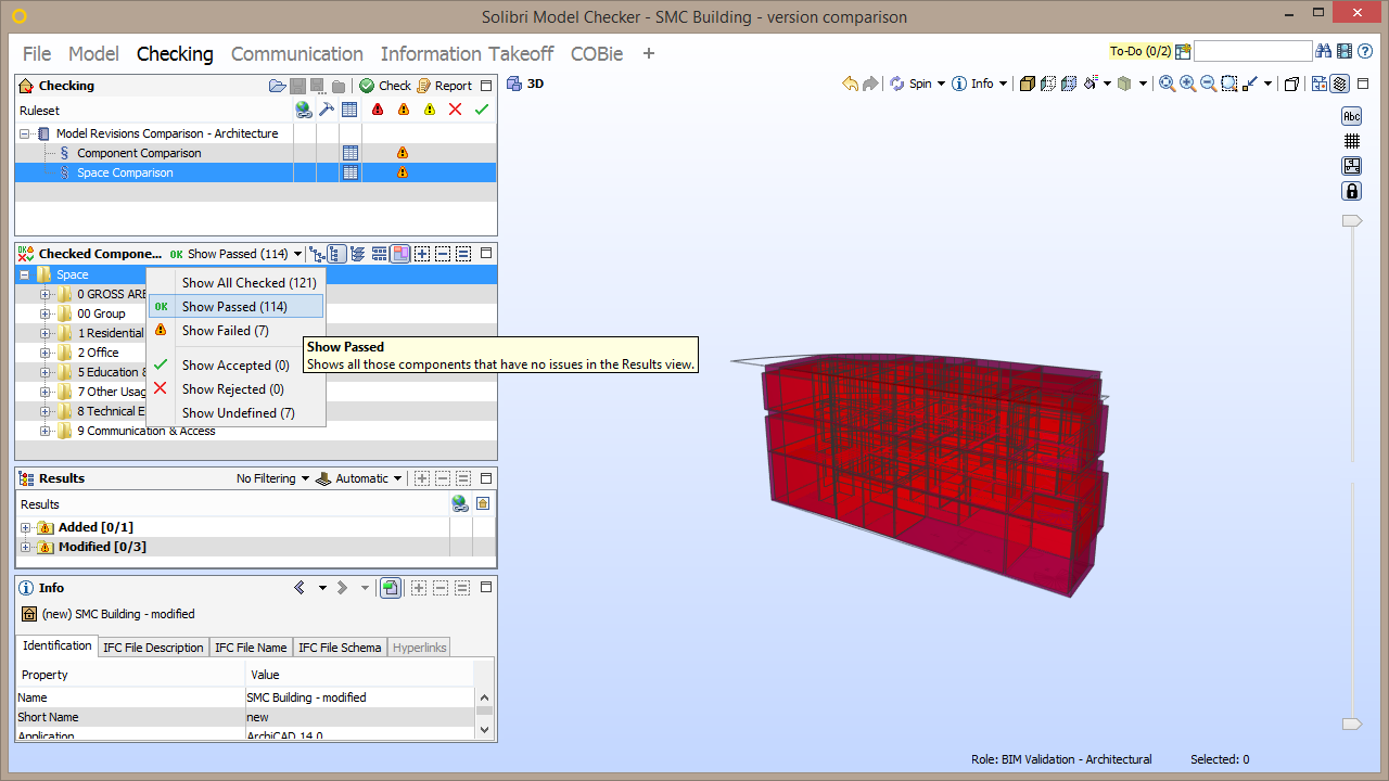

If it is shown as checked, you can then return to the Checked Components window and select ‘Show Passed’ to verify that it did in fact ‘Pass’ the model comparison check, and therefore was unchanged.
If it still appears in the 3D window while in the ‘Show Passed’ mode, the space was not changed between versions.
