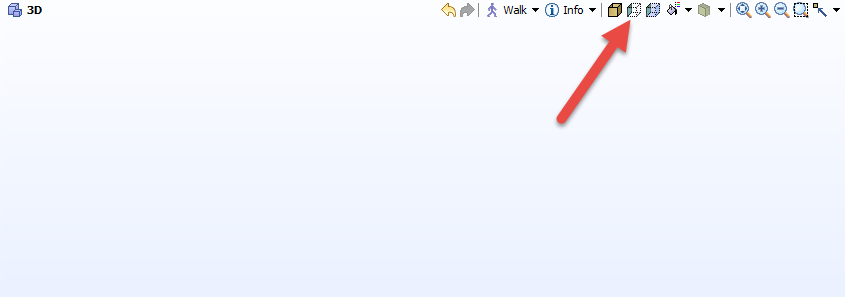

*This article assumes a general knowledge of how to run checks for issues in SMC, and will begin with a check having already been run.  Start by running a check in Solibri Model Checker.  Once the results have been generated, hide everything in the model in the 3D view.

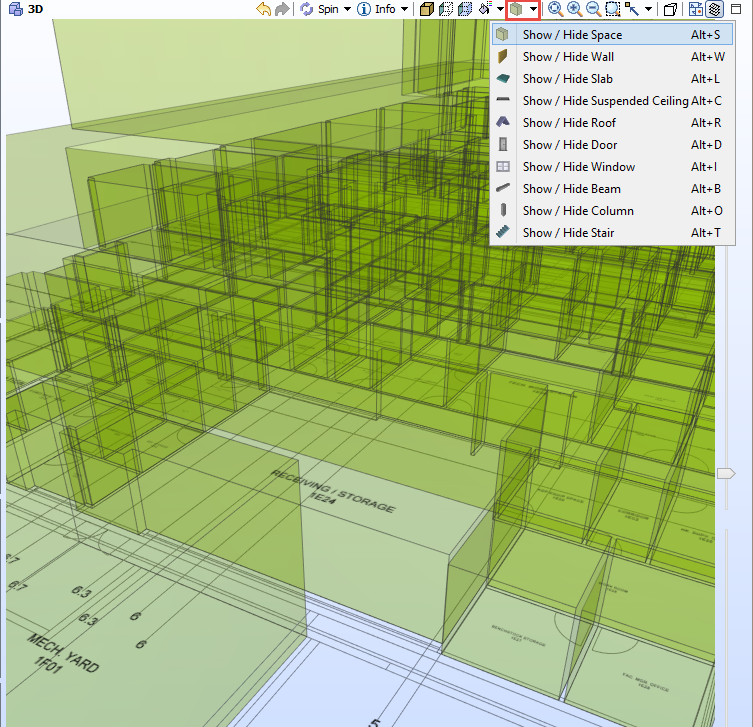

Then, select the Show/Hide Space option to show only the spaces.

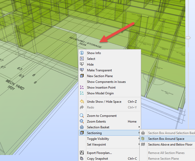

Right click while hovering your mouse over any space.  Select the ‘sectioning’ option, then choose “Section Box Around Space.”

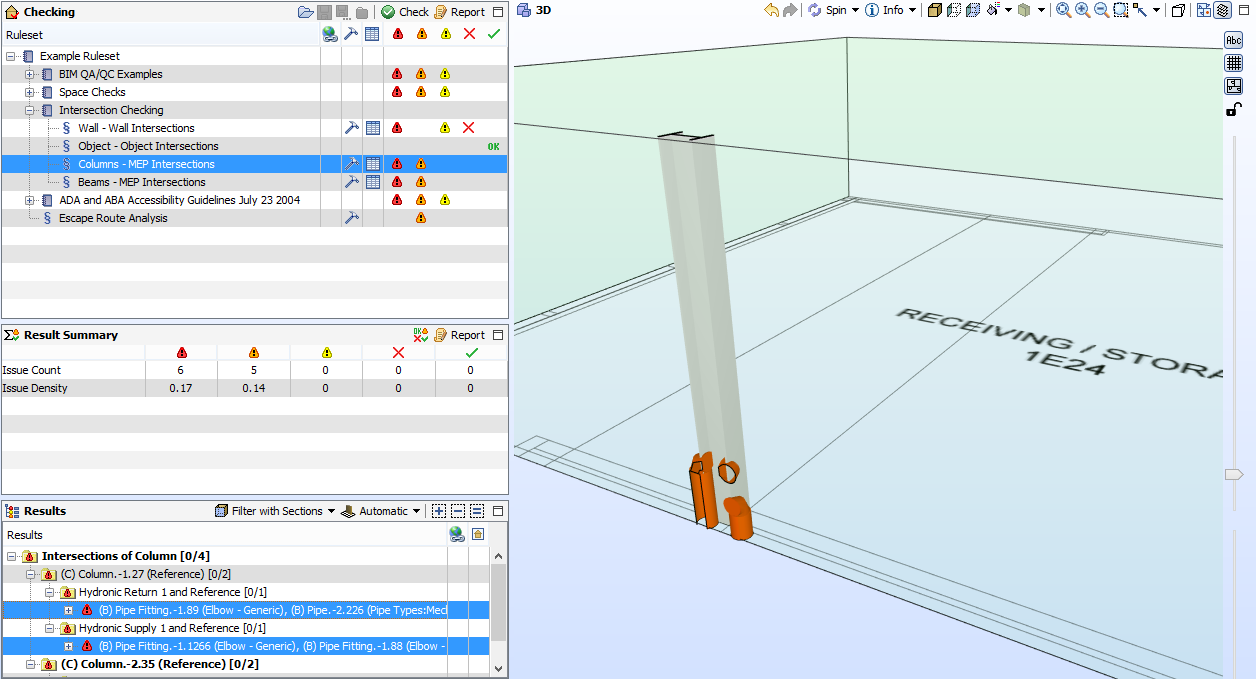

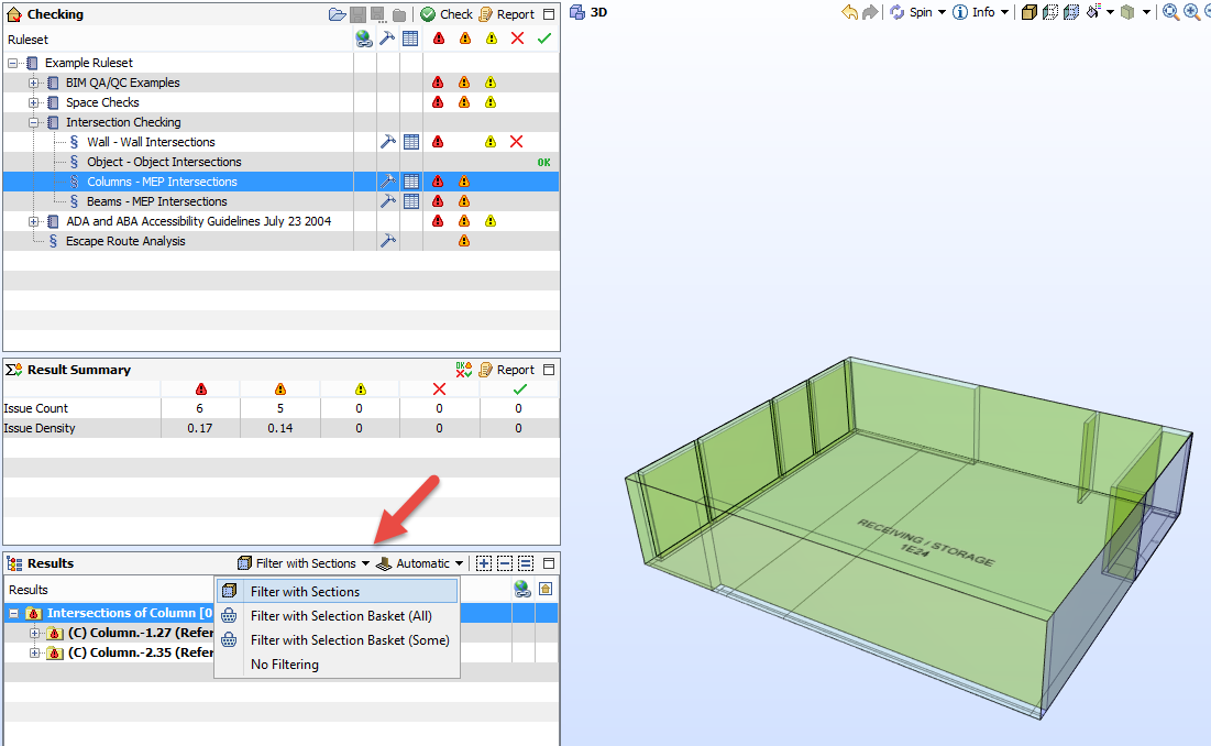

You will now see only the chosen space.   Move to the ‘Results’ window, and change filtering from ‘No Filtering’ to ‘Filter with Sections.’
Now, as Checking Results are reviewed, only issues relating to, or within that space will be displayed.  You can quickly assess the situation in particular rooms (such as electrical or utility rooms, or laboratories) without having to review or sift through other less relevant results.   The issues for a specific space can be reviewed and then reported as a group, before other areas of the building are dealt with in broader coordination sessions.
