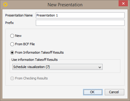

From the Communication Tab, select “Create Presentation.”
You will see the options to generate a slide “From Information Takeoff Results.”
New Presentation Option: From Information Takeoff Results
