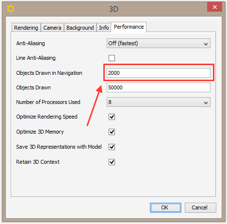

If the issue is still unresolved, there are two more possible solutions:
Graphics Card issues can often be resolved by unmarking File > Settings 3D > Performance > Optimize Rendering Speed
For complex intricate models such as HVAC or Plumbing, lowering the number of “Objects Drawn in Navigation” under File > Settings 3D > Performance will provide smoother navigation.
