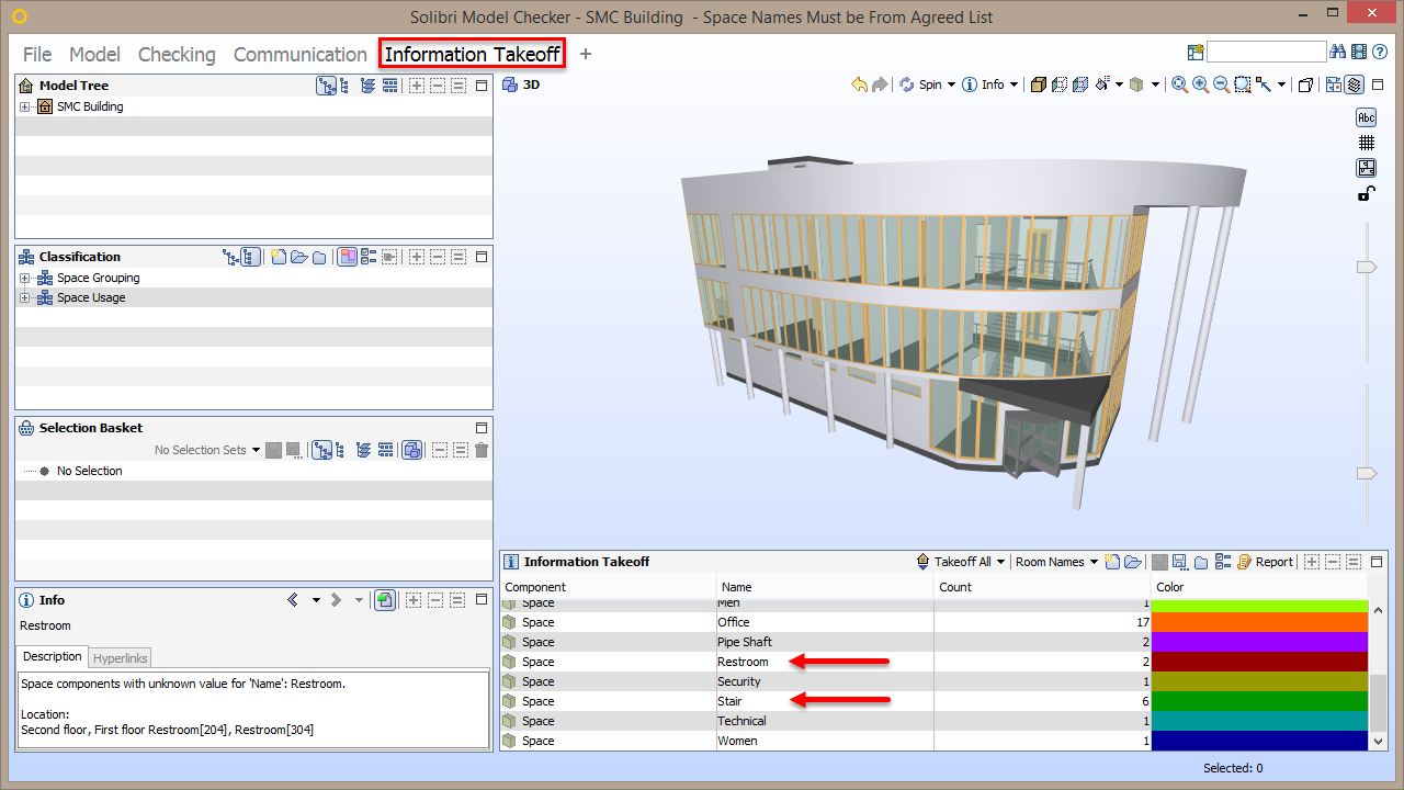

After opening the model, click the Information Takeoff Layout.  In the Information Takeoff view, you’ll see a takeoff of all rooms with their corresponding names and counts.  Notice there are 2 rooms named “Restroom” and 6 rooms named “Stair.”

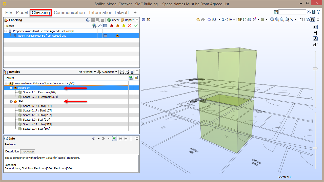

Select the Checking Layout and expand the results of the Room Names Must be from Agreed List rule.  Notice that there are 2 result categories that group the Restroom and Stair spaces.

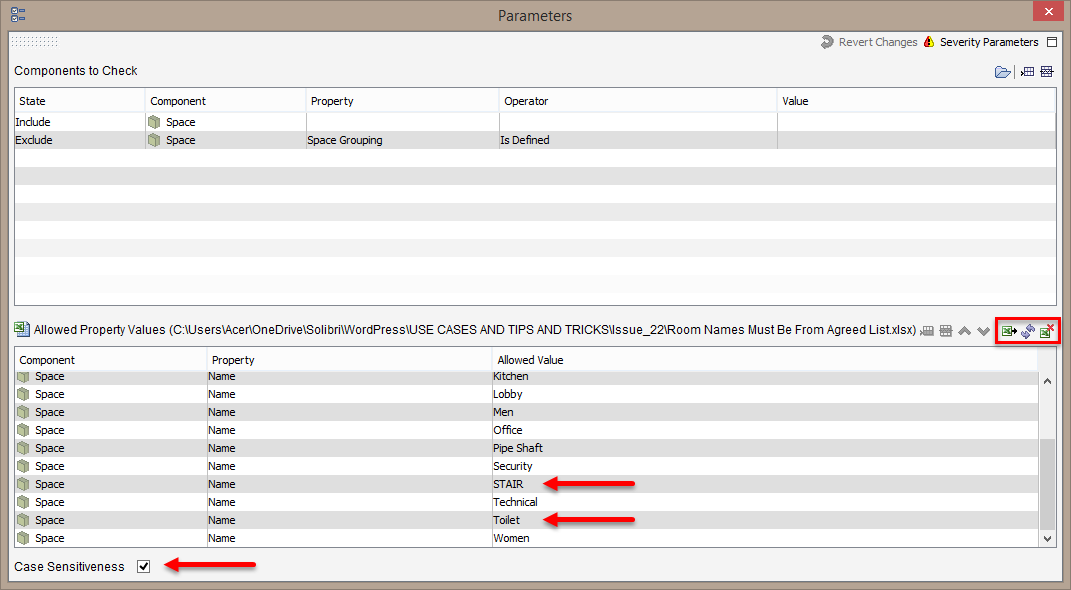

Right-click the rule in the Ruleset view, and select Rule Parameters to see the parameters of the rule. In the Components to Check filter parameters table, we are checking spaces, but excluding space groups such as Gross Area spaces, since those types of spaces won’t follow a naming convention as that of room names.
In the Allowed Properties Table, notice that there is no “Restroom” listed as an allowed value for the name of a space, as “Toilet” is listed as the agreed value. This explains the result stating that “Restroom” is not an allowed value for the name of a space.
Also, notice that “STAIR” is listed as an allowed value; however, the Case Sensitivity checkbox is marked.  This explains why “Stair” (which is not in all capital letters as in the list) is listed as a result, as well.

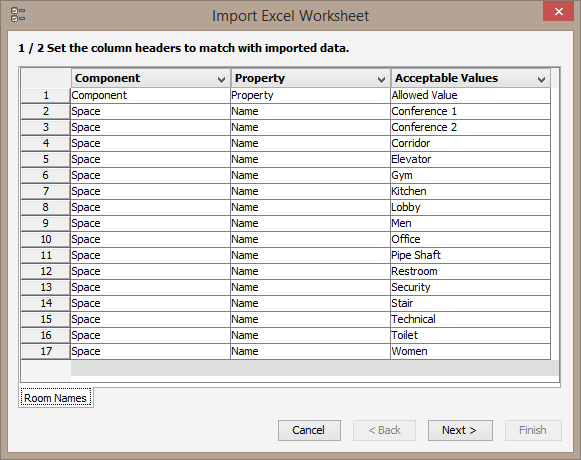

This first page of the import dialog allows you to map the Component, Property, and Acceptable Value parameters to specific columns in an excel sheet.  Since, the columns in the excel sheet were setup to match those same parameters respectively, you can click Next.

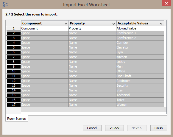

The next page of the dialog requires you to hold down the CTRL key and multi-select rows from the sheet. If you simply click Finish, nothing will be imported since nothing is selected.  Notice, the first row was not included in the selection as these values are column headers in the excel sheet.

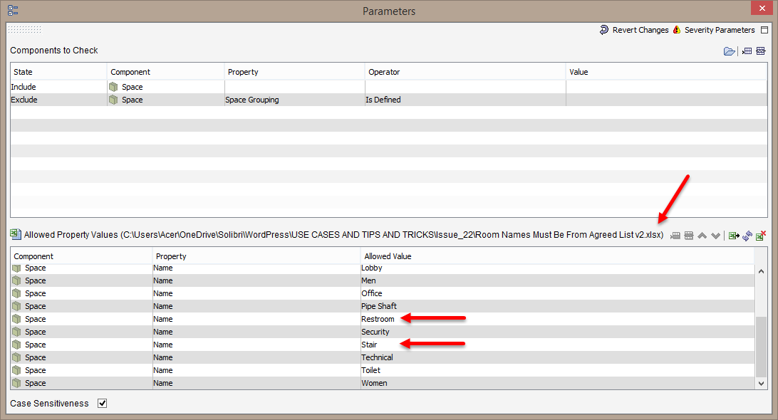

After clicking Finish, the data table is updated with the values that match those within the model, and the Allowed Properties Values link is now pointing to the new version of the sheet:
If you re-run the check, you’ll find there are no issues, as all room names match those that are in the agreed list.
