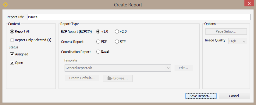

After creating several slides of other issues, a new presentation is created from the checking results in the Communication layout.  Once the presentation is created, a report of the results is generated. In this Create Report dialog, the BCF Report v1.0 option is selected and a report is saved, which can be sent to the user of ArchiCAD.
Exporting a BCF report

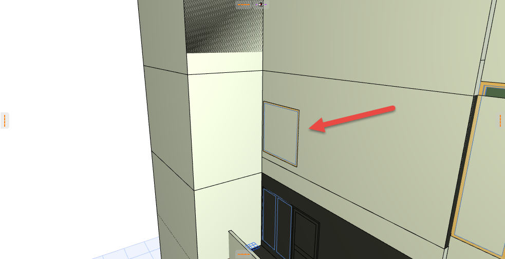

The issue is fixed by swapping out the window with another type of window that is shorter.
Issue resolved by replacing the window with a shorter one

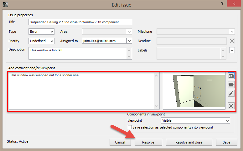

The ArchiCAD user adds a new viewpoint along with a comment within the BCF Manager, that they have corrected the issue.  The status of the issue changes from “Active” to “Resolved” by clicking the Resolve button.
Adding a comment/viewpoint about the fix and setting the status to “Resolved”

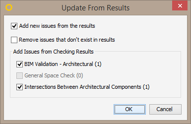

After updating the model to the new corrected version and re-running the check there is no longer a result in the Results view for the clearance in front of windows issue.  To update the existing presentation, right-click the presentation and select Update Presentation from Results.
Update Presentation from Checking Results of new model
In order to add new issues to the presentation, but allow existing issues that were resolved to remain, mark “Add new issues from the results,” but leave “Remove issues that don’t exist in results” unmarked.
Add new issues, and leave issues that no longer exist.
