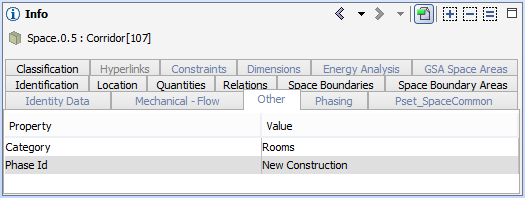

If the Corridor 107 room is selected, the Area Scheme ID property is not defined because the category of the space is a room and not an area.

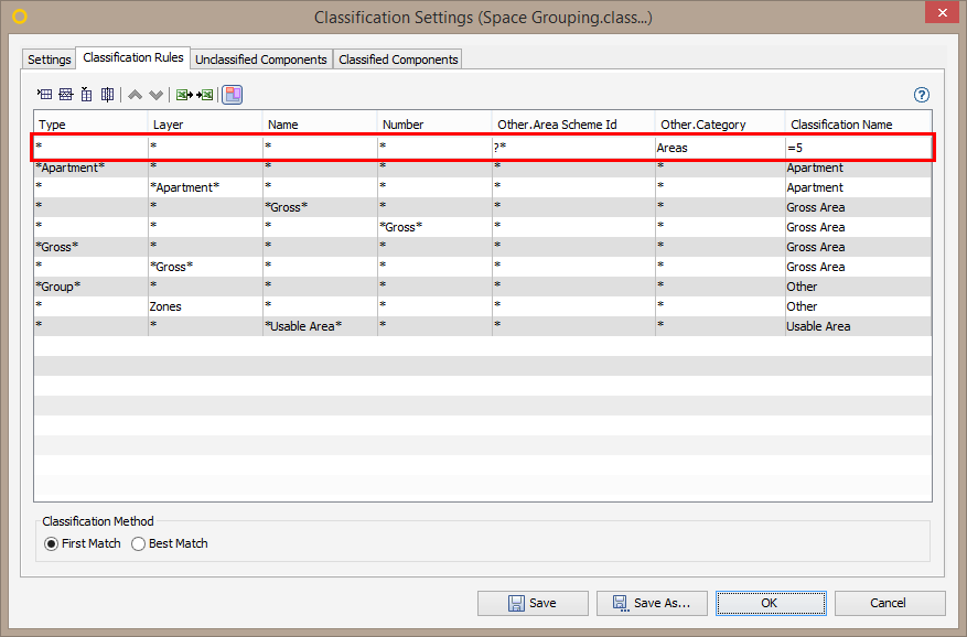

These properties in the Other property set make it simple to classify space groups in SMC using classification rules in the Space Grouping classification.  Below, we’ve added a row to the classification rules that matches any spaces that have the value “Areas” in the Other.Category property. Those area spaces will have their classification name set to whatever the value is of the Other.Area Scheme ID.
You can download this modified space group classification from the link below to try with your own Revit models that contain area plans:
Space Grouping.classification
