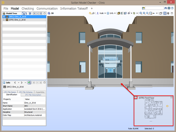

Once a model is loaded in SMC, the Navigation Map tool can be loaded by selecting the Show Navigation Map icon in the top right corner of the 3D window.
The Navigation Map will appear in the lower right corner of the 3D window. Selecting the upper left corner of the navigation map, and then dragging the window to the desired size will resize the navigation map.

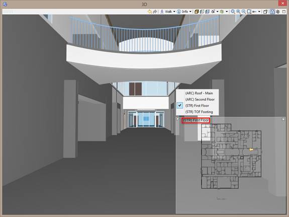

Lastly, you can select the name of the Floor listed in the Navigation Map to reveal a list of the floors from the architectural model.

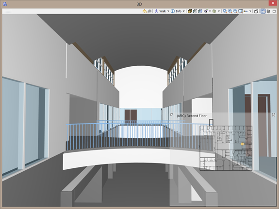

Select a different floor, and the Map will reflect the new floor. In the 3D view, you will also see the view moves up or down to the new floor selected.   This provides an easy way to toggle between floors while navigating.
