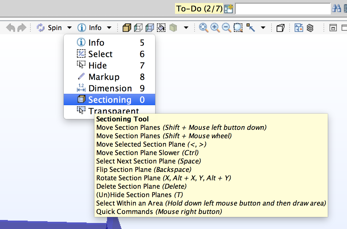

The section tool can be found on the Component Tools dropdown in the 3D View.   Mouse over the Sectioning tool to see all options that are available for sectioning (for example, note below that pressing the ‘T’ key will hide/unhide the section plane).

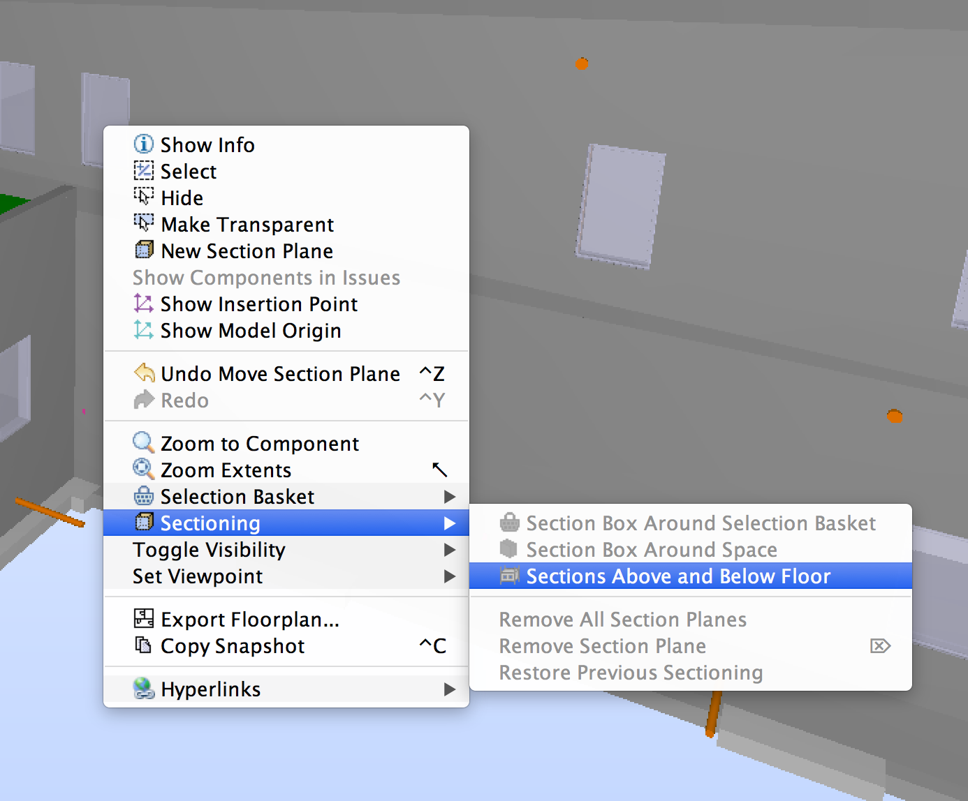

Once in Sectioning mode, create a section by either clicking on a surface to generate a parallel section plane, or by right-clicking and choosing Sectioning -> “Sections Above and Below Floor” while hovering the mouse over a component in the model. For example, if you mouse-over a window on the 2nd Floor, and then right click and select “Sections Above and Below Floor” the resulting Section View will be of the 2nd Floor.

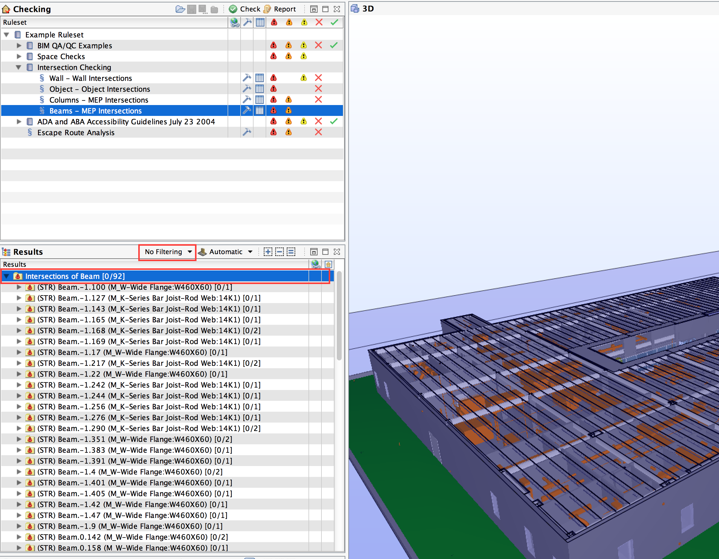

Once the section planes are set up in the correct location, in the Results View, change the “No Filtering” option to “Filter with Sections.” In the screenshot below there are 92 issues and “No Filtering” is selected.

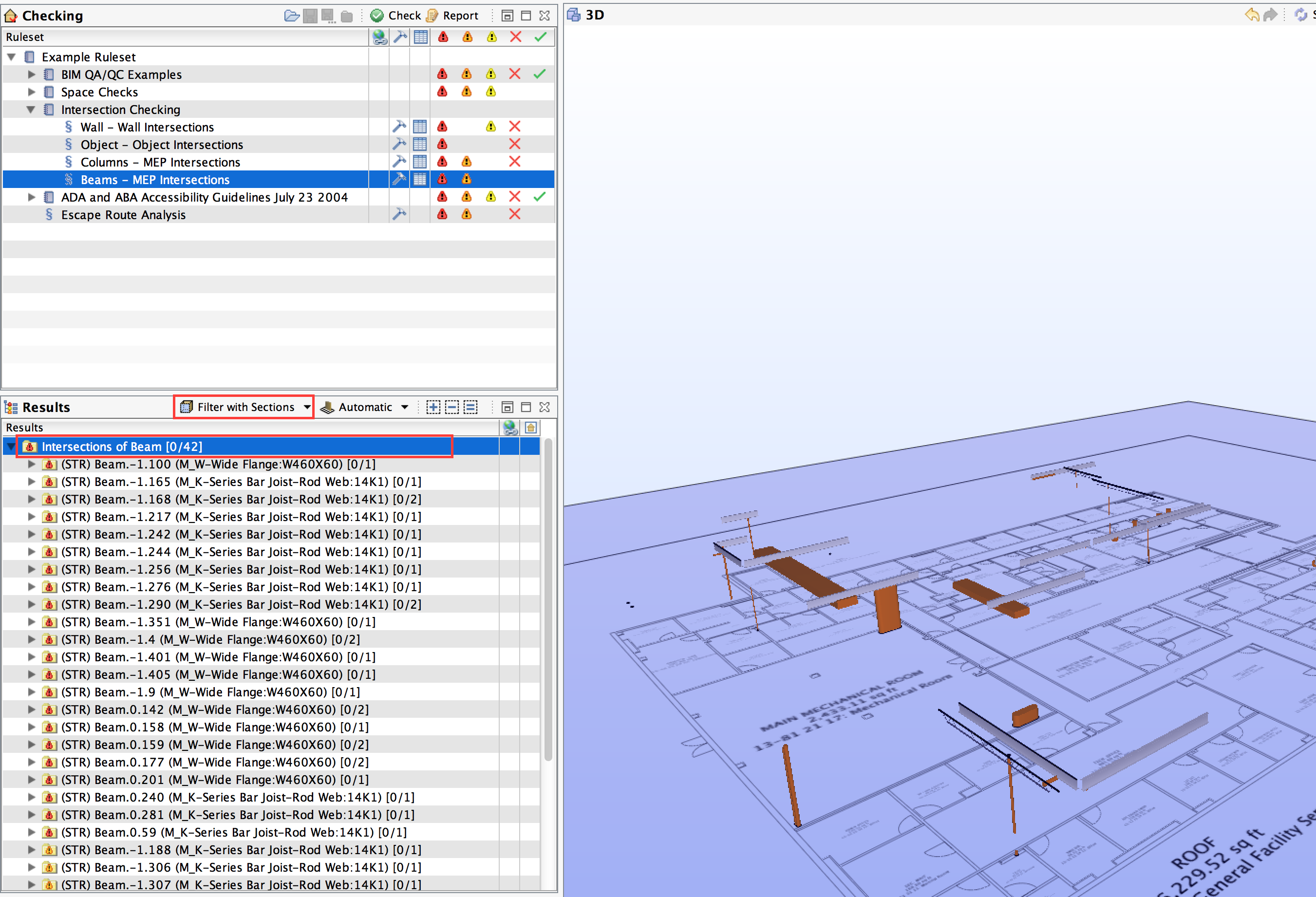

You will notice that by changing to “Filter with Sections” in the view below, the number of results is reduced to 42, and the remaining results listed reflect issues only within the defined section view.
From here you can address checking issues while maintaining a section view of those issues in the 3D View. At any point, in order to turn all issues back on in the Results View, change the Filtering option back to “No Filtering.”
