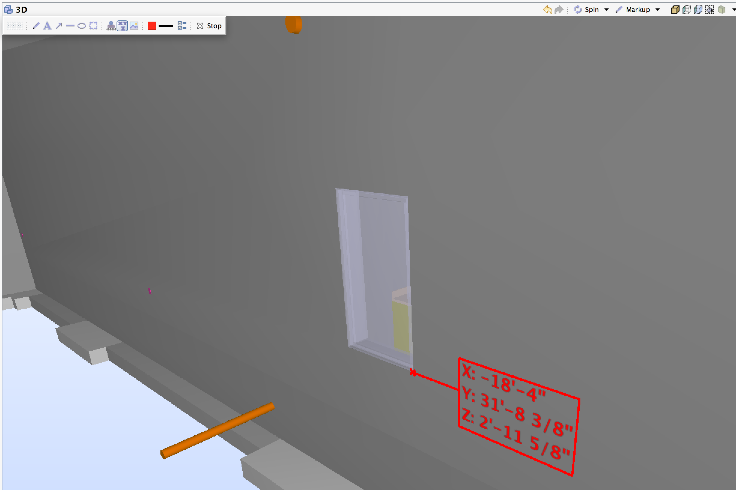

Coordinate Stamp:  The Coordinate Stamp allows you to “snap” to any surface in the model, and generate a “Stamp” listing the X, Y, and Z coordinates of that point.  This may be particularly useful for users wanting to display the location of some particular component where a problem may be occurring, or simply to give a bearing of where in the building a component is located.
From the 3D window, select the Tools dropdown and choose the Markup tool.  The markup tool ribbon will appear in the upper left corner of the 3D window.  The default option selected, the middle button, is the Coordinate Stamp.

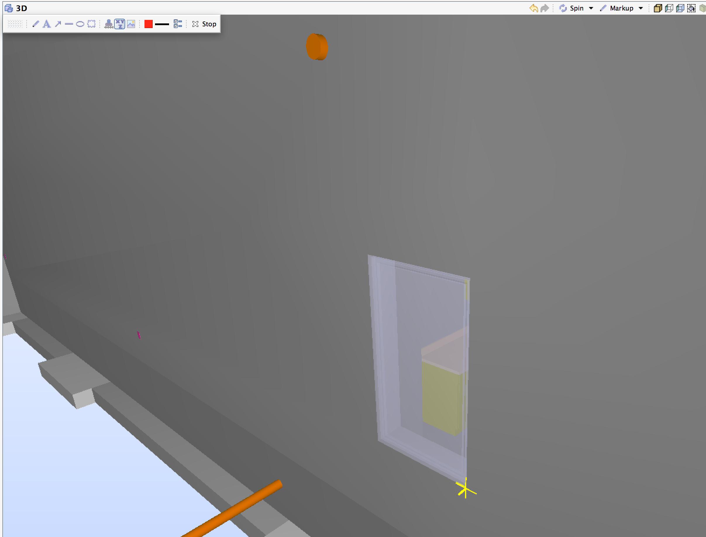

As you move your mouse over the surfaces of the model, you will see a yellow indicator showing where your mouse will “snap” to if you left-click.  Below, the corner of the window is selected.  (You can also choose to place the mouse at a random point on the wall; the stamp does not necessarily need to be placed at an endpoint or corner.)
Click the mouse for the coordinates of that point to be displayed.

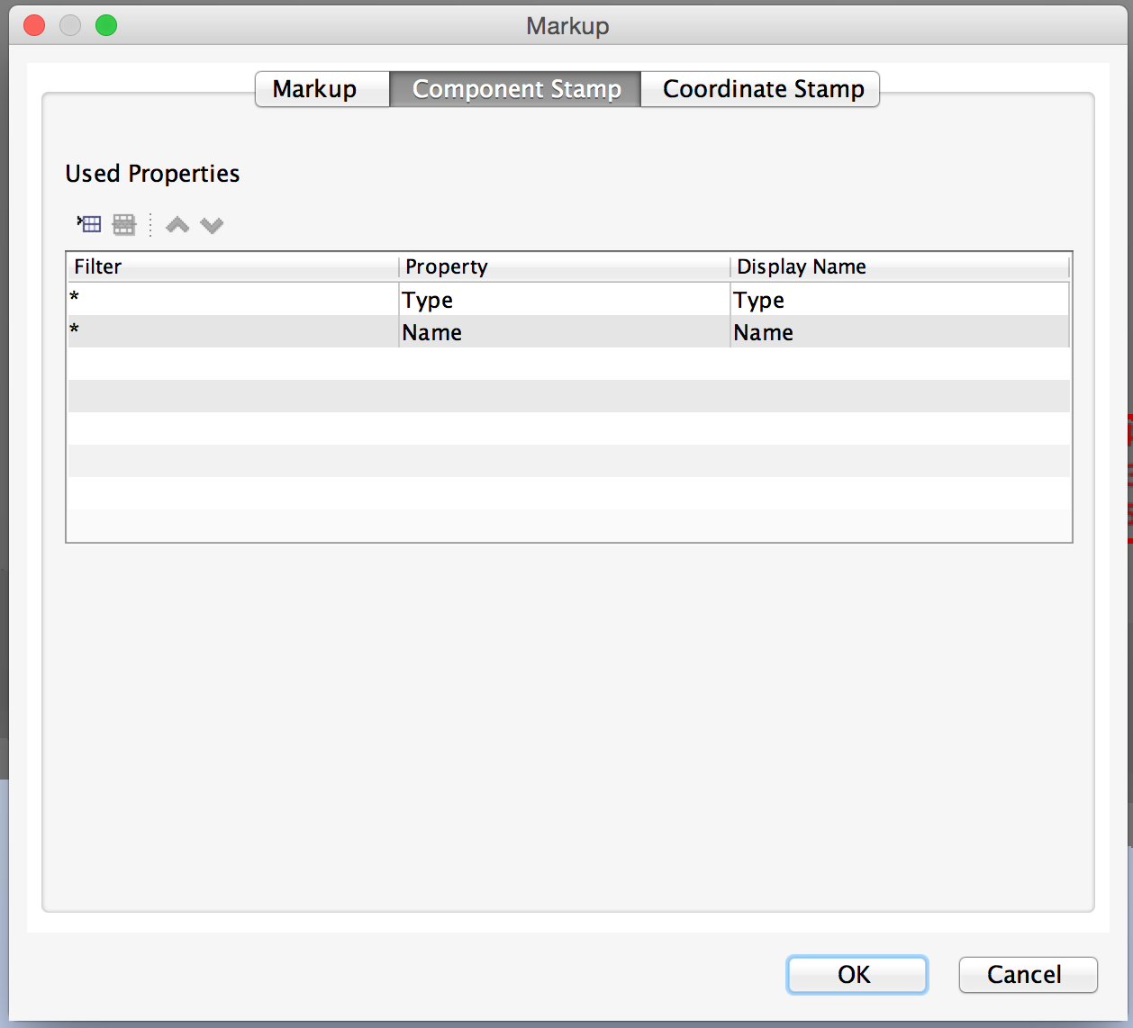

Select the File Tab, and choose Settings. Then, Select the Markup option, and you will be taken back to the Model Tab and the Markup settings will appear.
The default displayed properties for the Component Stamp are Type and Name.  So, if you were to place a component stamp in Solibri Model Checker, that is the information that would be displayed.
By selecting the Add Row icon, a new row of property information appears.  Select the three ellipses in the Property column to change the property from Type.
Displayed below in the Select Property window is the same Property Name information as shown in the Info window. So by changing the Property from Type to Classification Description, Solibri Model Checker will now display Classification Description as part of the stamp.
Since the Classification Description and Type may contain redundant information, or the Type information from the modeling software may be generic or incomplete, select the Remove a Row option to delete the Row containing the Type Property.  Now, instead, listed below Name, the Classification Description will be displayed as Type.
Hit Ok to close the Markup Settings window, and select the Component Stamp icon from the Markup Ribbon (the one left of the Coordinate Stamp). Now, click on the wall.  Displayed on the model wall is the Name and Type (or, Classification Description) of the wall.
