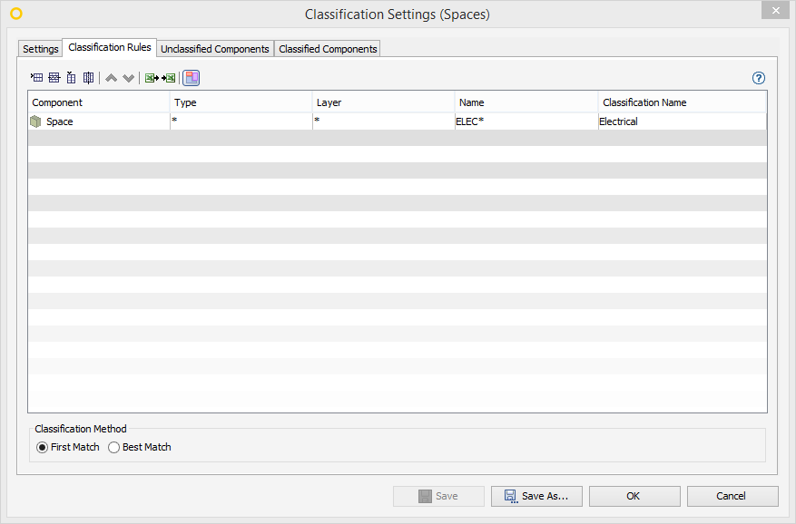

In order to find spaces in the model that are electrical rooms, classification is used to map those spaces either by their name or some other distinguishing characteristic such as an OmniClass number. Below we see the mapping of any space that starts with “ELEC” to the classification “Electrical”:
what-makes-smc-unique-the-ability-to-check-for-logic-and-behavior_01
Spaces with names that start with "ELEC" map to the Electrical classification

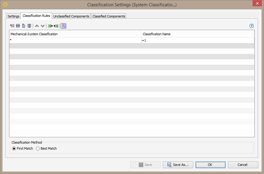

To check if plumbing is of type Domestic Cold/Hot Water or Sanitary, we need to know what property set/property pair stores that information. Again, using classification allows us to map to that property location and set the Classification to the value of the property automatically.  Below, the “System Type” classification sets a classification name for any component base on the value of the “System Classification” property found under the property set “Mechanical”:
what-makes-smc-unique-the-ability-to-check-for-logic-and-behavior_02
Mapping the System Classification to the value of the Mechanical.System Classification property

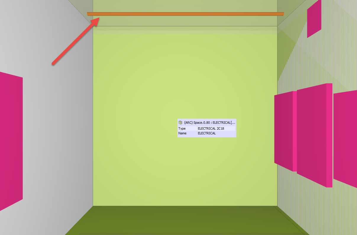

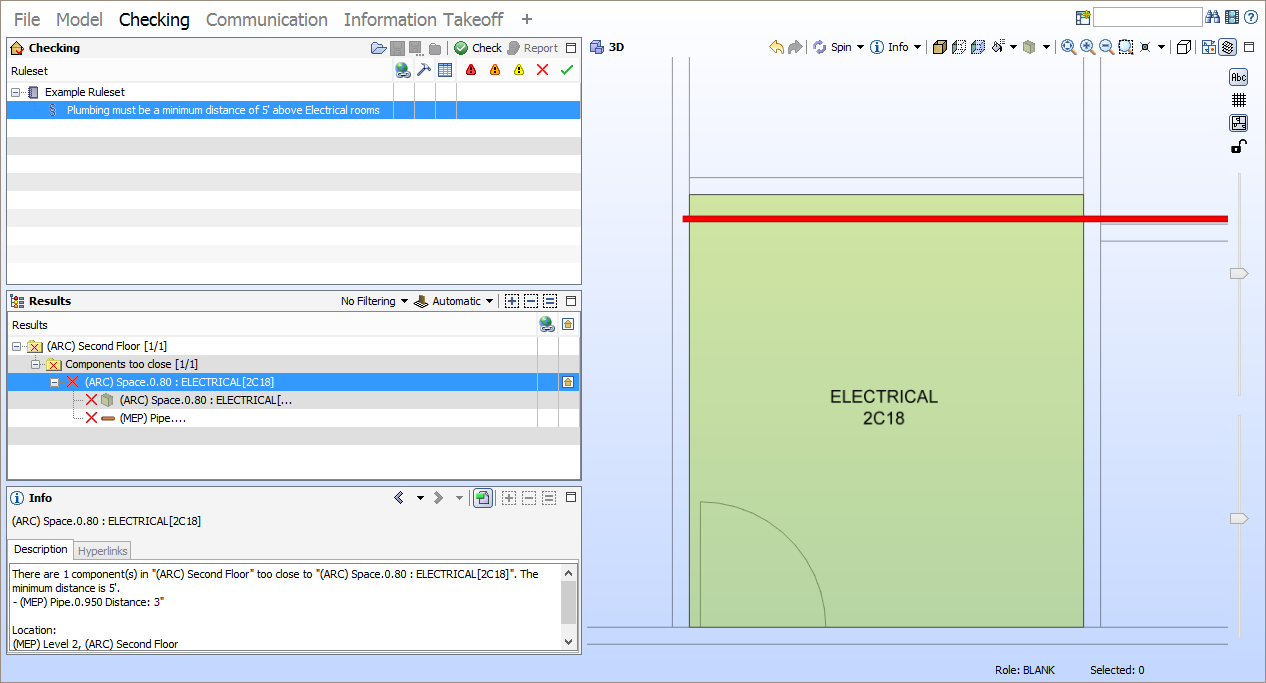

After running a check on a model, there is a result in which a pipe on the Sanitary system is running 3″ inches above the space in the model.
what-makes-smc-unique-the-ability-to-check-for-logic-and-behavior_04
An issue where Sanitary pipe is 3″ above Electrical space
Another view shows that the pipe runs above the suspended ceiling across this electrical room that has electrical panels:
what-makes-smc-unique-the-ability-to-check-for-logic-and-behavior_05
Another view of the result

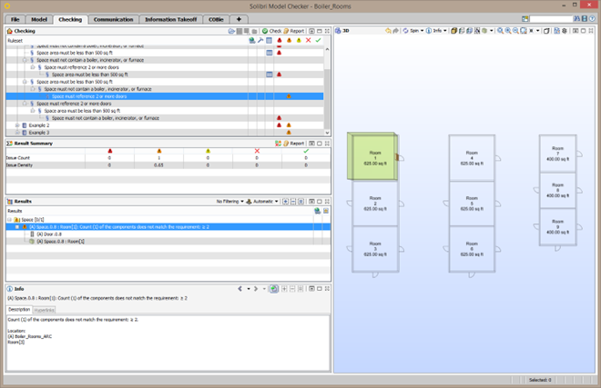

Rather than using the name of the space to determine if it is an electrical room, the SOL/225 – Number of Components in Space rule template could be used to return any spaces that contain electrical equipment as a result.  Using this as a Gatekeeper rule, the spaces returned as results are then fed to the sub-rule SOL/222 – Component Distance as the source component to ensure any plumbing has a minimum distance of 5′ above those spaces.
Gatekeeper rules also allow SMC to chain multiple conditions together.  Below is the example from the article Self-Configuring Rulesets: Gatekeeper Rules that checks that any space over 500 sq. ft. and that contains a boiler, incinerator, or furnace must have 2 exit doors.
what-makes-smc-unique-the-ability-to-check-for-logic-and-behavior_06
Gatekeeper Rule with multiple chained sub-rules
The logical statement based on the chained gatekeeper rules and their results is:
IF a space is more than 500 sq. ft. and IF the space contains a boiler, incinerator, or a furnace THEN that space must reference 2 or more doors.

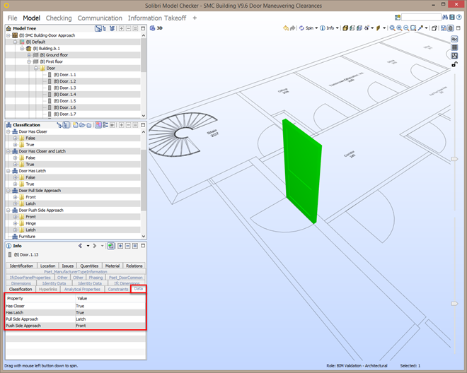

Below is a single-swing-right door that has the behavior of how it is approached from the push and pull sides included in the Data property set.  On the push side, it is approached from the front.  On the pull side, it is approached from the latch.
what-makes-smc-unique-the-ability-to-check-for-logic-and-behavior_07
Door with a latch on the pull side

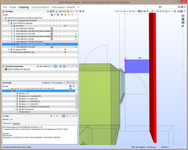

Again, a gatekeeper rule is used as a logical check to return any doors as results IF they have a latch approach on the pull side and IF they have a closer attached. Those door results are then passed to the sub-rule that checks for the clearance areas in front of the door, and past the latch based on that type of approach.
Below you can see a result where there is not enough clearance perpendicular to the door:
what-makes-smc-unique-the-ability-to-check-for-logic-and-behavior_08
Clearance past latch of door
