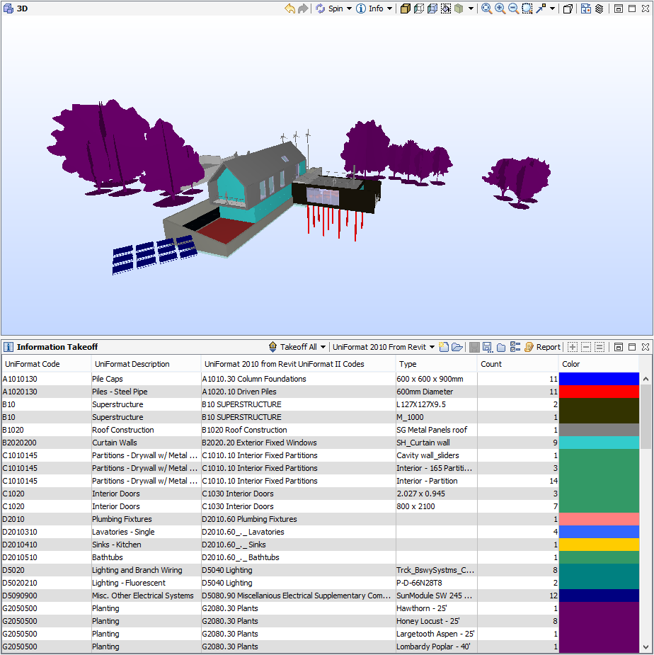

The Assembly Code property used in Revit are versions of a UniFormat II code. Through classification rules, these codes can be mapped to their respective UniFormat 2010 categories.  The following shows an ITO that reports the original UniFormat code and description from the assembly code and description along with the mapped UniFormat 2010 category using the UniFormat 2010 from Revit UniFormat Codes classification.
UniFormat 2010 categories from Revit UniFormat II codes
